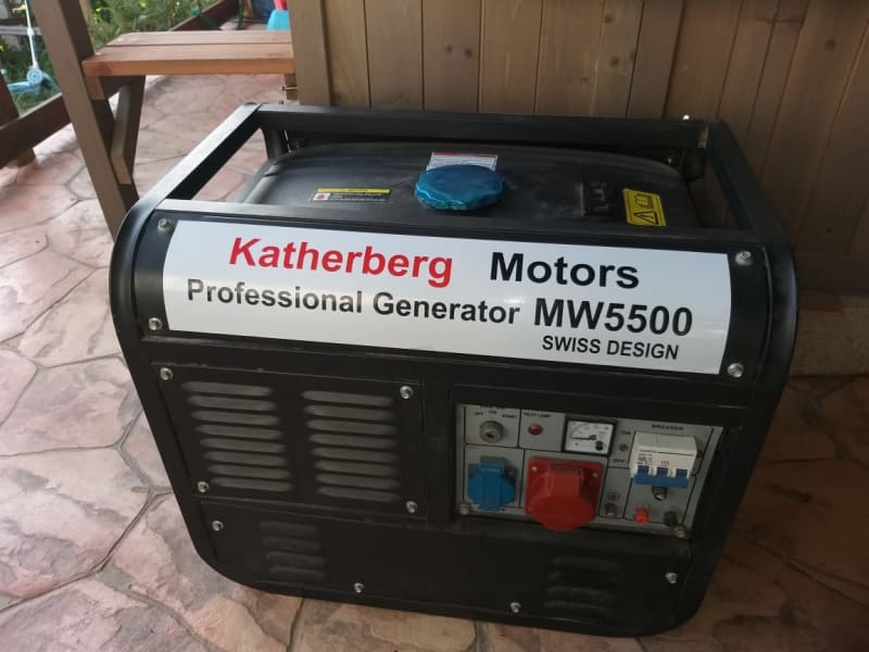

Your unit appears to be one of these?? Seems to be an "Excalibur dragon CX generator.
They are listed as 5-0/60 htz machines s there may be a switch or adjustment in the control panel to make it a 60 htz machine?
I can't find a manual online or even a decent picture of the control panel. Can you get your mate to send you a good picture of the control panel?
Or the manual?
I guess I'm used to NEMA nameplate ratings and not Harbor Freight ratings.
Or the manual?]
Find below additional information on the generator in question.
Jairo
Jairo,
What's going on here?
That picture and generator is not the same thing as your original sheet which clearly lists a much smaller generator.
the 5500 appears to mean 5.5 kW but there seems to be even less information about this other than some sites in ecuador!
Rather surprisingly the machine or any other information doesn't say if this is 50 or 60 htz.

Not completely sure about the spec sheet either. This is what they provided. I'll take a better look and see if the specs match. Nevertheless, it's a 50HZ producing Genset that they want to use to supplying 60hz equipment.
And 220v at 5.5 KW is nearly 25 Amps.
All the info on these seems to be South American.
I would just start it if it can be started, plug it in, stand back and see what happens....
