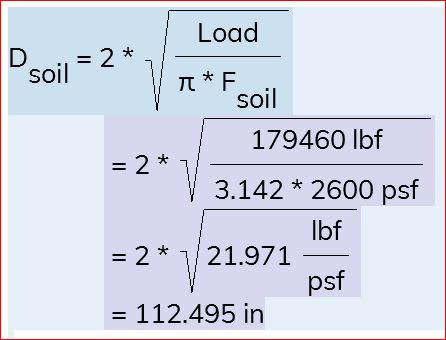

One thing nice, for structural and civil engs., is the ability to display equations with the variables filled in for documentation purposes:

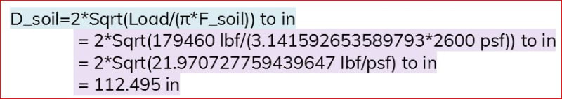

Here is a simple equation from Mathcad:

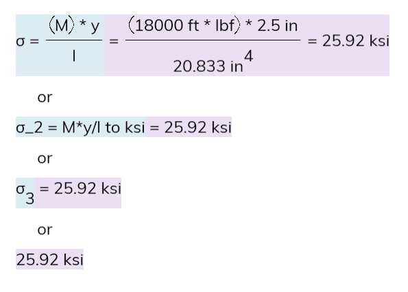

If you want to show your work, it does this:
and the equation syntax you typed in

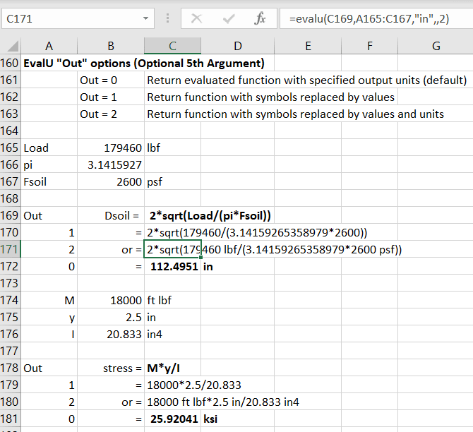

I have added to my Units4Excel spreadsheet the option to return the function with symbols replaced by values with units:
Download from:
Doug Jenkins
