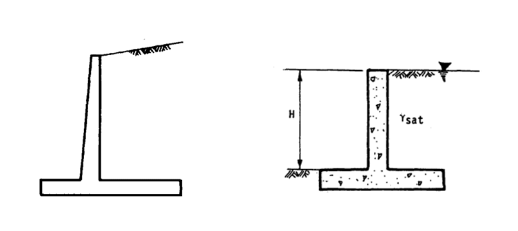

I'm looking at a retaining wall with a heel on the fill side, the heel aids significantly in sliding and rotation stability, because of the weight of the soil. I've read a number of texts to try and determine to what extent the degree of saturation reduces the effective weight of the soil, but haven't been able to find anything definite.

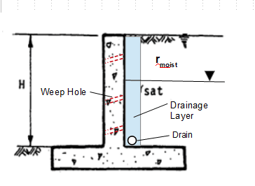

For a fully saturated soil, some texts mention a buoyant condition, ie, uplift. The second image below may be hypothetical, maybe not, but a saturated condition is shown on one side ... see further notes in next paragraph. At the other end of the scale, for a low degree of saturation, I would suggest that the effective weight of soil increases.
The closes I've gotten so far ... is from a text called "Foundation Design" by Wayne C. Teng, see attached extract. The text mentions that a rainfall event could cause a saturated condition, if there are no drainage measures. It mentions uplift at the surface of sliding and base of the retaining wall. It then states that you should add drainage measures for an economic design. But there is no quantification for the reduced effective soil weight. It does mention flowlines but I'm not really comfortable with extrapolating from these.
So given that I will have a drainage strip and pipe, how could I quantify the effective weight of the soil for a saturated condition.
Has anyone done this using flowlines? Or is there a rule of thumb somewhere, with the soil type as a variable.
IMHO, you should provide adequate drainage to entirely prevent any hydrostatic surcharge and buoyancy, or if you cannot assure that surcharge and buoyancy will be prevented, then you should design for that possibility, assuming fully saturated soil will occur at the highest expected level and considering that level to generate full hydrostatic pressure, producing full lateral load and buoyancy conditions. I would never attempt to design a retaining wall for partially saturated soils. Soil should be considered as fully dry (for inward rotation design case), and if there is any possibility for saturation, assume that it is fully wet up to the highest expected water level (for outward rotation design case).
It must be the COVID that causing you to overthink the design of earth retaining structure. The soil weight is influenced by water/moisture content, but the change has no bearing on the design, as we either use the moist weight, or design for fully saturated condition. For a wall with properly designed drainage system, the water in soil will be drained. The speed of dissipation of pore water pressure (from saturation to moist), thus variation in soil weight depend the soil properties and many other factors, which is too much to discuss in here. But I suggest to start from a review of void ratio and water content, and have an understanding on how soil weight is determined. Here is a starting read.
Theoretically, if there is even the smallest space adjacent to the wall that can fill with water, you will have full hydrostatic loads. It does not depend on the amount of water in the soil. Given equal height of a column of water, a 1"diameter column generates an equal hydrostatic force as a 1000'diameter column.
OK thanks for the responses. If I understand correctly, the design would be based on either a drained condition or a saturated condition.
The issue with the saturated condition is that it is uneconomical for a retaining wall with a heel. The buoyancy loads would be more than half the weight of dry soil, the lateral hydrostatic pressure would be more than the lateral earth pressure, the passive effect on the other side is much reduced. All up, your disadvantaged by a factor of at least 4 ... this is assuming saturation is right up to the top of fill, all hypothetical I'm sure.

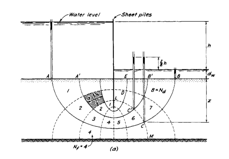

I have trouble with the flow net from Teng (and flow nets in general). Equipotential 9 is at ground level on the low side which is the water level. Why is the pressure there h*gamma_w? Why not zero since it's the water surface? Why no fountain spurting up to top of wall?
Maybe understanding this is the key that's missing from my knowledge.

On top of the heel, it supports Ws = ϒ(moist)*h, for moist soil, or Wtot = [(ϒ(sat)-ϒ(water)+ϒ(water)]*h = ((ϒ(buoy)+ϒ(water))*h, for fully saturated soil, the resulting pressures are not drastically different, but, when we consider uplift below the heel, u = ϒ(water)*(h+t), the game changes. So, yes, buoyancy is the problem that causes instability.
Check the direction of the buoyancy load, I suspect it is acting upward against the soil weight.

You need to review the flow net beneath dam with water in different elevations. The pressure at downstream toe simply is the head differential times the density of the water. Google the word "flow net", you may find useful articles for review.
I think maybe I misunderstood Teng's description. This from Peck, Hanson & Thorburn (1974) matches how I expected flow nets to work. On the left side, the water level in a standpipe inserted into the ground would not reach the free water surface outside the standpipe.
Referring back to Teng Fig 4-13(a), the uplift at the toe would be equal to the toe depth * gamma_w plus 1/9 * h * gamma_w. At the heel, it is the same except 4.5/9. This uplift is less severe than hydrostatic (ie buoyancy) based on the retained-side water level alone.
More simply, it's a weighted average pressure depending on how close (measured along the flow line / counting equipotentials) the point in question is to the two boundary water surfaces.

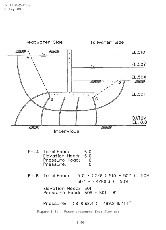

What I wrote above for pressure along the flow path isn't quite right. See image below which has the USACE reference number at top left - nice and clear. That document also has an approximation that doesn't require drawing the flow net. Worth reading.
