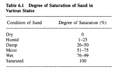

I came across this articles discussing pressures due to water in soil.
[URL unfurl="true"]https://www.readingrock.com/sites/default/files/reconmistakes.pdf[/url]
There article makes a distinction between moist and saturated soils ... and a system which retains moving water.
My question is: How do I know if I've got a moist/saturated soil or the latter. Care is required in defining "saturated", the last time I used the term, I didn't place too much emphasis on the meaning but in this instance it does not infer that water is retained.
Where I'm coming from, is if I have a large rainfall event lasting a few hours or a leaking water pipe, which case is more representative. Are my loads increased by the order of 1/4 or are they doubled?
The retaining wall may be either gravity masonry wall without mortar, with mortar or concrete. Does that make a difference?
The soil may be sand or clayey sand.

Without knowing the type of soil, void ratio, water absorption characteristic, and conductivity, I don't think there is a rule-of-thumb kind of answer to your question. The linked article may help you to get start in the long journey. Link

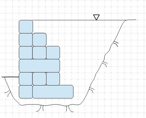

Your concern is real, but I think it is site and application specific, for which has many unknown variables. Please provide a graphical example for others to provide meaningful response and help.

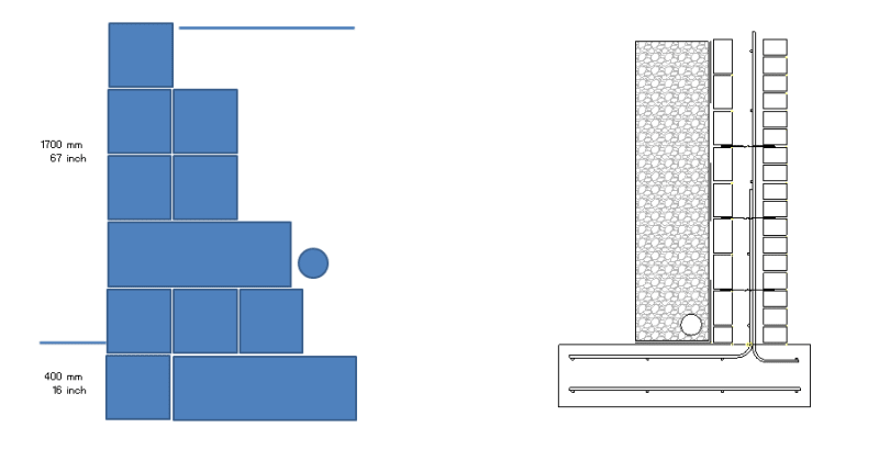

Thanks for the response r13. The typical retaining wall is shown below. Limestone blocks are used, natural or reconstituted, with and without mortar. Footing is sometimes present more often not.
The other common option is either a reinforced brick wall with a footing or all concrete. Both of these rely on the heel, whereas the first option relies on gravity.
The soil is typically sand if brought in as fill, or clayey sand if natural. Some areas are closer to clay but this is not as common.
For wall shown below, I would design for the maximum hydrostatic pressure, treating it as a retention pond, if the permeability of the original soil is sufficiently low (clay for instance); design for the reported/expected ground water, that is lower than the top of the wall, if the original soil is consisted of mainly gravelly soil, which can easily conducting and divert the storm water away from the wall. For both cases, weep holes are required if safety factor for sliding and rotation is lower than 1.5.
OK thank you. For the situation of designing it for groundwater, I assume this means like a damp/wet/saturated case, and not the hydrostatic pressure case.
