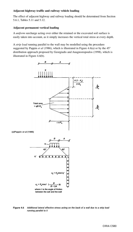

I'm using the Boussinesq Equation for surcharge loads and have come across the factor of 2 which some use.
Initially based on experiments a while ago.
Bowles gives recommendations in Section 11-13 (see attached).
This website has an article: [URL unfurl="true"]http://www.ejge.com/iGEM/Articles/FactorOf2/FactorOf2.htm[/url]
I don't have enough understanding and experience to feel comfortable either way, whether to use 2 or 1.
What are your thoughts.
Have you come across a definitive journal article which you think makes the correct recommendation.
Skip the argument about Boussinesq and use one of the methods described in CIRIA 760 (Georgiadis and Anagnostopoulos (1998) or Pappin et all (1986).

geotechguy1, I could not find CIRIA by Georgiadis and Anagnostopoulos. Would the method be such that you could compare with Boussinesq?

The alternative methods are helpful and I will try all methods for comparison. The method which includes the angle of friction to the wall will be interesting, as typically the soil retained has a strip of coarser material which apparently reduces the stresses.
steveh49 - I was thinking that looked just like CIRIA 760 and then I realized it's from the previous version (CIRIA 580).
Absolutely brilliant manual
