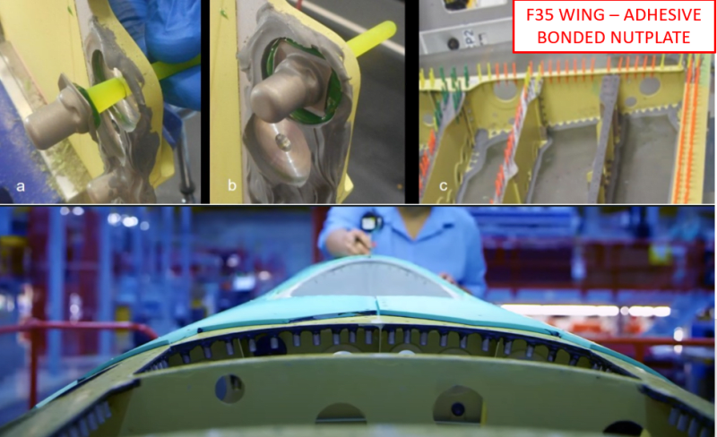

When I investigated the fighter jets which are F-16, F-35 designed by Lockheed Martin, I saw some details for fastener selections at non-accessible areas.
At F-16 wingbox, elliptical nuts (NAS 1734) are used to attach upper skin to under structures.
At F-35 wingbox, adhesive bonded nutplates are used to attach upper skin to under structures.

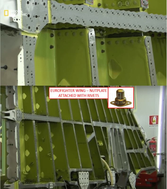

At Eurofighter, nutplates attached with blind rivets are used to attach upper skin to under structures.
American fighter jets don't prefer usage of nutplates having rivets so that they reduce the hole numbers on spar and ribs. On the other side, Gripen and Eurofighter uses traditional nutplates having rivets (NAS143, NAS1474 etc).

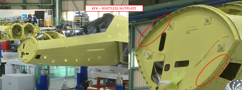

Also, KF-X fighter jet uses rivetless nutplates for radome attachment. I'm not sure whether they are adhesive bonded nutplates or not. They can be Forcetec rivetless nutplates too.
I have some qestions&concerns about these different solutions. Why do Europen fighter jet designers still use these traditional nutplates? Or do they not trust the these new nutplate designs (FTI rivetless nutplate, Clickbond adhesive bonded nutplate)? Or do they have no idea about these solutions yet? Alright, which nutplates do you prefer for non-accessible areas having fuel inside for composite skin and aluminum spar attachments?
Thanks in advance.

Just focusing first on the location you mentioned: the internal (wet) side of a fuel tank, here are some questions to ask when evaluating different fasteners:
  • Potential for fuel leakage through nutplate mounting rivets
  • Potential for fuel leakage around elliptical nutplate in circular hole
  • Potential for pressurized inerting gas to leak around nutplate
  • Potential for fuel to soften/dissolve the adhesive holding the nutplate
    - enough to release the nutplate
    - enough to prevent torquing the fastener
  • Adequate Electrical bonding contact to reduce hot-spots during lightning strike
  • Procedure to replace a nutplate with stripped thread
  • and you will get along better with your boss if you never forget: Cost, lead time and lifetime availability of a specialty fastener

Don't forget the age of the airframe design, the F16 first flew in the 70's, Eurofighter and Gripen in the 80's, F35 in the 00'S, while the KFX hasn't flown yet. Updating the hardware is very unlikely unless there are issues or other drivers like politics or major airframe revision, just because they maybe better isn't a sufficient driver for change.
In addition to sparwebs comments, the stock system (or IPC for those doing modifications to airframes) is a good place to start looking for fastener, everyone is happy when the new fastener already used somewhere else.

OEMs stick with techniques that work for them .. and their employees (& repair facilities) are confident in using.
Changing hardware for marginal benefit & later discovering an issue really hurts the OEM with customer confidence, warranty, etc ..
- (from Regional Jet perspective) - at one time bonded nut plates were the fad - until it was realized adhesion was only as good as the primer underneath.
.... and worse yet - non-OEM applied primer failures.
- Blind fasteners (multi-alloy composition) are much more susceptible to corrosion or initiating corrosion to adjacent structure.
- Myself, Being involved with a MRO - replacement "advanced technology" parts are almost non-existent to locate. Salesmen convince the OEMs in purchasing sufficient lots for production. But the Parts Mfr facility has no interest in sales of less than 1000 items outside the OEM (& they do not keep expensive inventory) .. and in a time frame that is practical to the MRO. MROs with tight out date schedules - just go 'ballistic' with the OEM who does not have the part & cannot obtain the item.
- Stick to what is common practice, works & is available. Consider the additional Tooling & training costs to the MRO when replacing "advanced technology" fasteners. Everything will eventually get replaced - why handicap yourself for Marginal benefit.
