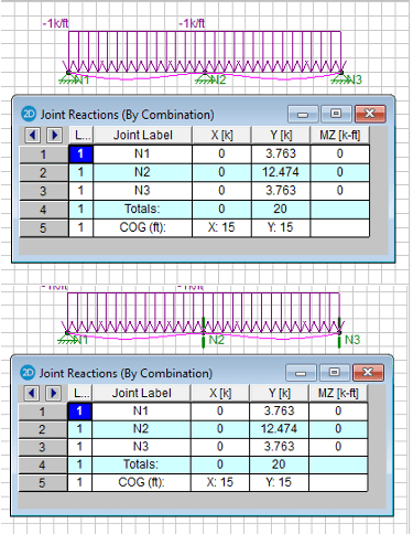

Regarding to the 3 rollers system, it is unstable, so theoretically there is no solution, and in reality, no one shall do it. But strictly speaking, in a limit equilibrium situation without any cause for lateral movement, the vertical reaction under each support is identical to that obtained for a stable system.
The image below compares results from the 3 pins system, and the system with 1 pin and 2 rollers. No warning was issued from the program.
I would not expect a warning to be issued for those conditions as they are both stable systems; but you will find different results for shear and bending moment if the supports are placed at the bottom of the beam. With three rollers you should get a warning.
BA
Additionally, with respect to the analysis r13 presents above, I'd expect the 3 pin case you present above should have horizontal reactions to maintain equilibrium as the beam cannot shorten under the flexural loading if restrained horizontally at all supports. You get some catenary action and tension in the beams. This is why the beanding/shear/axial/deflections will all be different as stated by BAretired. Not sure why the 3 pin analysis isn't showing an x direction reaction on the N1 & N3 supports?
Everything BAretired has added in his last 2 posts is correct here
Most likely, the beam was modeled as being rigid or very stiff. No bending = No deflection = no change in the length of the beam = no horizontal forces.

I think in general purpose structural analysis, the program ignores the secondary effect, that produces horizontal reaction at pin support. Evident by another examples below - left end fixed, right end on roller, or pin support. A person familiar with structural programming should be able to point out why, or RISA has committed a mistake.
We know in reality, secondary effect shall be included to obtain true reactions afford by the pin support, that is important in design of the connection. Also, in reality, for beam over multiple supports, imo, should be modelled as beam supported by multiple pin supports, unless there is clearly no physical horizontal restrain at the interface, which is rare.

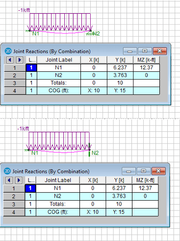

I'll let the sketch speak itself. [Sketch was withdrawn and revised]
r13,
Your sketch speaks with forked tongue.
When pin supports are placed at the bottom of the beam, they must resist a horizontal reaction. If there is one pin and the remainder rollers, there can be no horizontal reaction. See simple span at the left in sketch below for support location. The bearing point of a pin or roller is not at the neutral axis of the beam. It is usually at the bottom as you show on Sections 1 and 2.
Try relocating your pin supports h/2 below the neutral axis by using a rigid extension from the neutral axis down to each pin and let us know if you get horizontal reactions.
BA
Unless the beam has a relatively (compared to the load) very large moment of inertia, having more than one pinned connection in the structural model will produce different results for the reactions than if there is only one pinned support. Unless the supports are really very rigid (and it's difficult to imagine how that would ever be accomplished in a real structure), modeling multiple pinned supports will result in model that does not come close to reflecting reality.
Unfortunately it's telling lies, that picture is wrong in the sense that if you apply a concentrated horizontal load to the end of the beam at the support location as shown in the bottom picture with 4 pins, all of the H load is resisted by the first pin supoort. The beam doesn't distribute the load to all four pin supports as implied.
You don't need a computer analysis, just some basic understanding of statics (usually 1st year stuff at University) to follow the logic.
