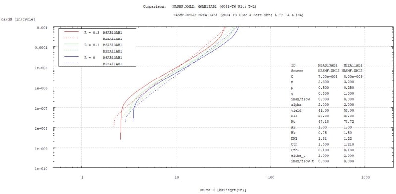

Looking at the S-N curves... 6061-t6 looks shifted to the right of 2024-t3 by an entire exponent (if that's how one even says that???)...

6061-T6 sheet actually has a higher detlaK_th for typical stress ratios. What is the peak stress in your part and can you show the max deltaK is below the threshold?
If you're looking at S-N data you might be able to show the same type of thing for the "endurance limit". But of course, there's always the question of whether the motor induces and vibratory loads, but that depends on the design. You should ask the DER why he feels this should be considered fatigue critical structure. From my perspective, I would be more concerned with the attachment holes you are putting in the frames, and the effect on the continued airworthiness of the OEM frames. Does your part create a hardpoint on the frames? Focusing on the motor mount itself seems odd to me without more detail.

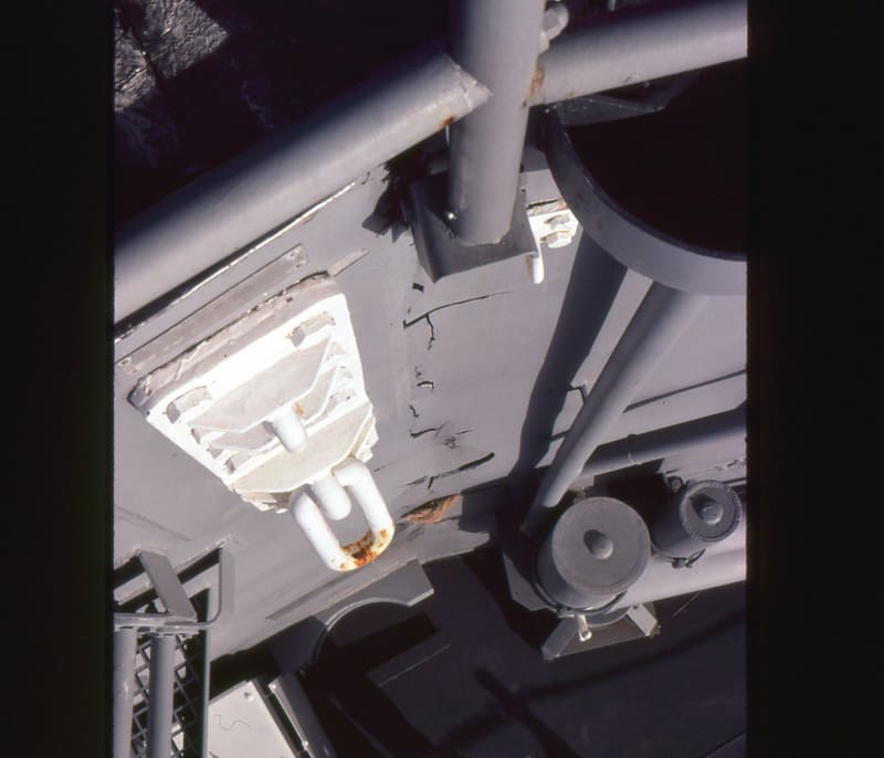

A whole lotta years ago, I served on a Perry Class frigate. The superstructure was aluminum, I'm pretty sure it was 6061. They were notorious for cracking. I took these pictures after we were caught in a storm for 3 days.
Wouldn't want to see that happen to my airplane.
