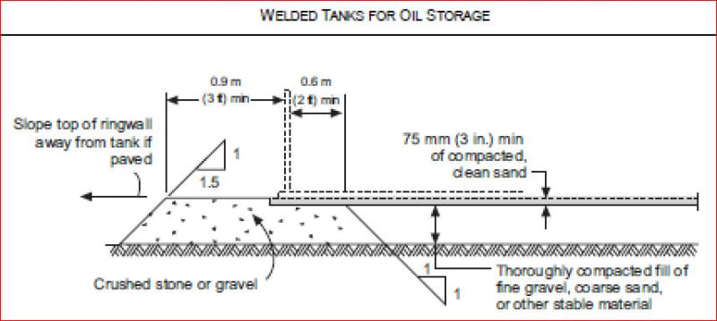

With proper fill inside the ringwall and hoop bars in the ringwall you should not have much differential settlement from the inside of the tank to the shell. As far as the tank settling unevely, that's not a big deal for the tank, especially one this short but it could be a problem for the piping, so perhaps look into that? However, I agree with BigH and am of the opinion that for this short a tank a concrete ringwall is not needed since the load per square foot is pretty small in the grand scheme of many soils. I'd spend my money on characterising the soils under the tank footprint and modifiying those as needed, then use a gravel pad, perhaps using API 650 Annex B as a guide (see below).
Ring walls are primarily for confinement of the interior soils and essentially create a sand column. The ringwall only needs temperature reinforcement as the lateral stresses are generally small. Since you are in Texas, I would not consider the frost depth to be significant, though check per BigH's recommendation.

Ron Ring walls are primarily for confinement of the interior soils and essentially create a sand column. [b said:
The ringwall only needs temperature reinforcement as the lateral stresses are generally small[/b]. Since you are in Texas, I would not consider the frost depth to be significant, though check per BigH's recommendation.]
The hoop reinforcement for the ring wall is primary reinforcement and calculated for the active thrust loading of the confined soil and fill interior of the ring foundation...
