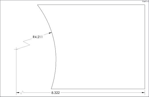

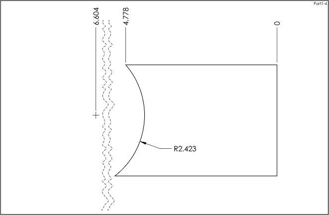

I have a radius I have dimensioned which is way off the border of the drawing, so I made the radius dimension forshortened. Then I went to dimension the center position, and it shows up way off the border, and there's no "foreshorten" display option for it. What may be the solution for this?

The OP mentioned in the title that he's talking about ordinate dimensioning.

2. I am curious if OP could make an exception for radii dimension.
3. This is what they call "ordinate dimensions":
4. If OP desperately needs to use rectangular coordinates, they can be also be tabulated, or simply put next to forshortened radii center: X=..., Y=...
5. Here is yet another possibility. This one is real, but it can be simply faked:
Checkerhater: That looks great. (the December 7th post) I cant seem to make that happen. Its not ordinate but it would at least be connected, and easy to understand without fudging. How do you get the linear dim to connect to that center of the foreshortened radius.

@borsht:
To get it the way shown in Dec. 7th, I created both, radii and locating dimensions first. (There could be third - for "Y" direction)
Then I right-clicked on radii dim and picked "Display options" -->"Foreshorten".
Both dimensions become foreshortened at once.
I have 2018, but I hope it will work on your 2017 as well.
Good luck.

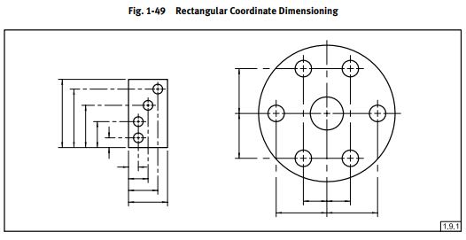

Actually your sample is not ordinate dimensioning. Here's a sample ordinate dimensioning. Most commonly used on things like large die plates with lots of holes. Preferred for those applications because it requires fewer lines, its less crowded.

"5. Here is yet another possibility. This one is real, but it can be simply faked:"
I like your sample. Creative way to solve the problem.
