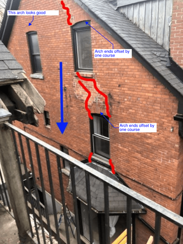

hello everyone,
I recently did an inspection of a old victorian home in Toronto. While doing the inspection i noticed that the outside brick wall has sagged around the archway windows and in some areas of the wall. Upon closer examination there were no lintels installed in the window arches and I think that contributed to some of the settlement you can see on the pics.
The brick settlement seems to extend above the lintel as well however as you can see from the brickline above the window.
The house is constructed with two rows of brick on the outside wall. I didn't see any settlement at the foundation level although the outside wall seems to have concrete parging.
The client wants to know what the best recommendation is to repair this issue and if there are any underlying structural problems. They are considering a re-work of the outside brick veneer but wanted to know if there are any foundation issues. Any opinion on what some of the causes of the brick settlement may be and what other clues I can look for ?
Thank you!

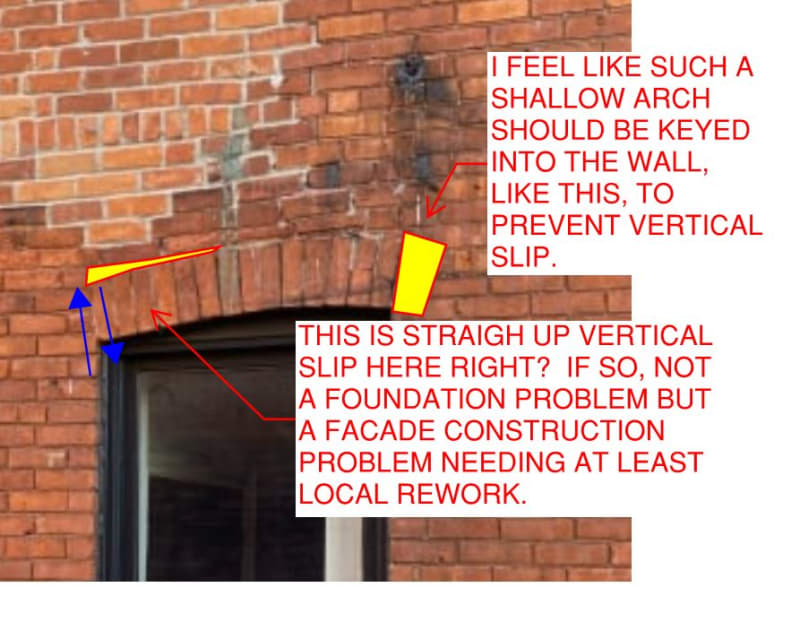

Looks like a arch formed in the brick over the lower window. When that gave a bit, that led to the issues seen. (Looks like it's been fixed before.)
I'd definitely fix it with some kind of curved plate/angle over the lower window (as a form for the re-work at least).

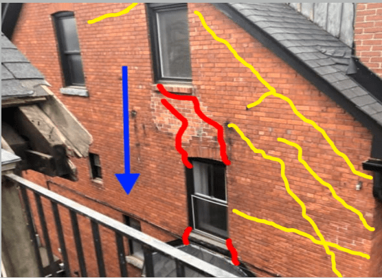

Looks like the whole left hand wall has sunk/collapsed by almost 1 course, and has been subsequently patched up at all the places it cracked.
Hey. The wall now isn't moving. Leave as is.
The upper brick is caving as shown by Tomfh, but the lower part is not (so foundation looked ok). Other suspicious areas of movement indicating wall softening.

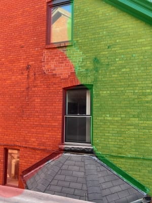

The whole left side (red side) looks to be lower than the right side (green side)?

In my opinion there has been a major shift in the majority of the wall, with the difference in height showing up as arch failures. One side of the arches are lower because that whole side of the building has dropped.

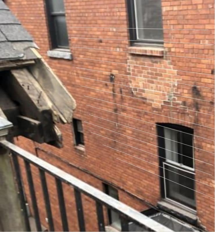

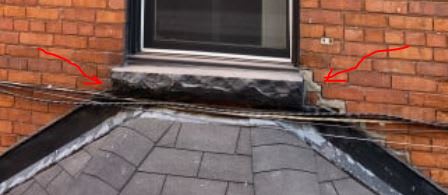

Here's a shot at the sill of the second floor window. You can clearly see that the brick opened up by nearly an entire course, and it was filled with mortar:

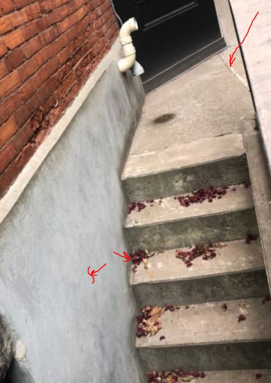

We don't have a good shot on the right side of the bay window at the foundation, but we do have the left side. Notice the crack in the slab running out from under the bay window. The coloration of the basement wall is also curious. Looks like the mortar parge was recently repaired. Can't draw any definitive conclusions from these, but I think it points to the possibility of some movement in the soils and perhaps some differential settlement.

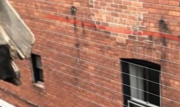

I don't see overall settlement. The coursing aligns on both sides of the failed arch, from what I can ascertain from the photo where I pull imaginary strings at the bed joints:
I think the crack at the bay window is more likely a failed lintel (I'm guessing wood) over the masonry opening at the bay.
Kip said:
The coursing aligns
In my opinion the coursing aligns because Side A has settled by a full course relative to side B:

Do you have any locations that should be the same on either side of the house? A coursing line and run it around the perimeter. You could do this with a typical header course (bricks turned 90 degrees). The wall does not appear to be well constructed with the difference in coursing thickness and the header courses each 10 course... normally it's about 7 courses max and often 5 courses. Checking the coursing line around the building will give an idea of what has settled. It looks like Tomfh is correct and that the left side of the building has settled.
Has the arch been constructed as non-symmetrical, or has the building settled? The one repair seems to have one deeper course extending to two less deep courses. Are there other arches that have a similar feature? If not, why was this one constructed in this fashion. Relatively flat arches are normally no problem with masonry as long as you have sufficient wall abutment on each side.

The wall is one course lower on side A. The repaired brickwork weaves across one course to make up the difference:
The offset is limited in the repaired area. Some old damage (brick tilting) on the lower right remains.
Tomfh is definitely correct about this,
It is highlighted in the picture below:
The differential settlement happens at the bay window so it isn't readily apparent in the foundation as the foundation isn't visible at this point.
