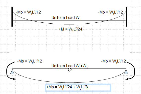

Here is my little contribution to your ending concern - the sketch shows a fixed end beam with an uniformly distributed load W1. A hinge is formed at each of the supports, as the connection was designed to plasticize at the maximum theoretical moment W1L2/12. Now the beam is further loaded with an additional uniform load W2, and soon the beam reached its design capacity Mp = W1L2/24 + W2L2/8, a hinge is thus formed. With 3 hinges in the system, the beam is said to be in a mechanism, that can no longer carry any additional load, in a sense, the beam has failed. Hope this helps.
Thanks for each of your contributions. The points I quoted below help make it clearer. My next question was going to be, "is it common, or acceptable, for parts of a connection to go plastic, assuming the beam design only needs a simply supported end?". I did a quick google search and found this article: and the quote "Unlike many of the other types of connections, shear tabs rely on inelastic deformation to achieve the rotation capacity of simple shear connections..." So, in the case of shear tabs, the connected beam is designed for a pinned end, but the shear tab restricts some rotation, to the point where small parts of it may yield, allowing further rotation. But, it would be important to know that the parts of the connection that are yielding don't cause a reduction in the shear capacity of the connection, right? You wouldn't have to think about this too much when using common or prequalified connections, but if using more arbitrary connections, like my angle weld in Case 2, you would have to reduce the shear capacity of the connection by the length of the leg that would "unzip", if your analysis shows it will unzip under the FEM.

A hinge is formed at each of the supports, as the connection was designed to plasticize at the maximum theoretical moment W1L2/12. Now the beam is further loaded with an additional uniform load W2, and soon the beam reached its design capacity...
That would be both common and acceptable.
I would say it is acceptable, provides you have a handle on which part will fail in ductile manner rather than brittle, and that's why the code specifies different strength adjustment (reduction) factors to safe guard the designs for parts with different structural behaviors/failure mechanism.
