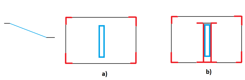

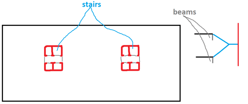

I understand the idea behind what you're talking about and I generally agree.
I was just wondering if the extremely stiff wall structure would change that, the idea being that walls will probably be very stiff on their own. I might be very much wrong, I'm bringing it up to try and understand the problem better.
It seems logical to me that walls should change the influence of the stairs since they can limit the drift and with that, stair activation. Look at the picture below. Is the stair activation the same for both case a and case b? I wouldn't expect them to be, but I might be way off.
I'm asking this because if I got the case b) or if I got the structure from the first picture, I'd simply ignore the stairs in lateral model, but in the case a) I'd definitely model the stairs.
RE: Modelling Staircases in Softwares for Structural Analysis
I think what you're trying to say is that stair cases enclosed within a stair core are analogues to a rigid diaphragm, ie as the walls are so stiff, then there will be minimal differential membrane strain and thus minimal diaphragm forces would develop?

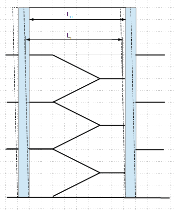

I think the force on the stair depends on the relative displacement of the floor and the adjacent landing. In a stiff core, the relative displacement should be quite small.

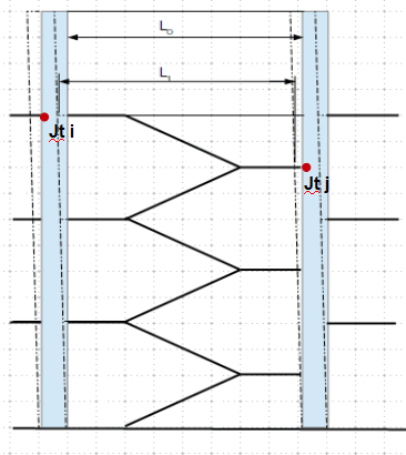

I think there is a simple solution, no matter there is core wall or not. Set up monitoring joints in your model at strategic locations, then find the absolute displacement, and design the member for the required strength to resist the force due to displacement (for small displacement), or design the sliding device to accommodate the displacement. For the former, some engineering judgement is required
