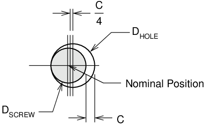

Here is my diagram of a screw and its clearance hole.
Both the screw and clearance hole are shifted opposite the maximum distance that allows assembly. I assumed that this was a clearance hole and the major diameter of a screw. Tolerances, whether they be [±] or positional need to be based on this model. If the "screw" and the "hole" are matching threads, I do not see this model doing anything useful. A screw in a functional tapped hole has a bit of clearance. You can force the screw off the centre of the hole by a very small amount such that the two axes do not line up. I do not see a functional difference between surfaces and axes. The threads are approximately conical and will force the screw into the centre. If your design relies on this not happening, your screw will be difficult to tighten down.
I am looking at a 1/4[‑]20UNC- class[ ]2 thread here. Based on pitch diameters from my Machinery's Handbook, I see clearances of between...
.2175-.2164=0.0011 to .2224-.2127=.0097
My standard clearance hole would be 9/32", which provides of clearance of at least 1/32=0.0312". My positional tolerance on the tapped and clearance hole would be [⌀].016". There is a bonus there, but not a particularly big, useful one. I am trying to visualise the geometry of the screw shifting in the tapped hole to fit through the clearance hole. Your screw torques on the production line will be interesting.
The maximum OD of the 2A thread is .2489". There is my bonus tolerance!
