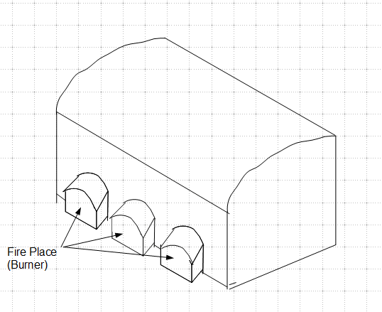

Yes, the brick was made from clay. In the early days, it was wet molded by hand, dried by sun, and hardened by burning. Depending on its location with respect to the burner, the color differs. At old time, the temperature was difficult to control to be uniform throughout; the lighter colored brick was the result of less heat received during the hardening process, and tended to be weaker.
Thanks, r13. I'm aware of the difference in strength based on distance from the heat source (which is why certain faces have to be directed outward), but I hadn't considered that a brick might be several rows away, leading to a similar phenomenon on all faces. Certainly makes sense, and is a lot more plausible than a different source clay used in some of the bricks and not others.
Yes, even the same source, the products from every batches differs to a degree too, the key is temperature and heat exposure.
The fuel was wood, or coal. Bricks were stacked in rows and columns.
phamENG....depending on the brick manufacturer and location, those bricks with lighter color likely had more sand particles....essentially a sandy clay before firing. Many bricks because of demand in the earlier brick industry, were quickly fired resulting in a relatively hard crust that was shallow , with the interior being relatively soft. When wetting and drying cycles crack the crust or just from the firing cracks, the interior would leach and the bricks would deteriorate.
