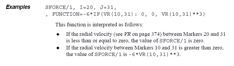

Hi, anyone know an idea how to limit this force function that it only works when the the slider is on the way back, in this mechanism?
I tried to use the "IF" function but I couldn't find a solution...
Maybe is some other way to implement this type of force?

I wanted to do it like in this example, insert DM (..., ...) instead of VR (..., ...) and then eliminate the force between the new markers added, in the unwanted range of that force
IF( DM(checkmarker1, checkmarker2) : 0 , 0 , AKISPL(DM(MARKER_18, MARKER_19),0, SPLINE_1,0)) or similar...

No you don't want to use DM in your IF test, you need translational velocity, assuming that all this happens on the X axis
IF( VX(checkmarker1, checkmarker2) : 0 , 0 , AKISPL(DM(MARKER_18, MARKER_19),0, SPLINE_1,0))
So this says if the velocity between those two markers is <=0, F=0
esle F=whatver your spline gives
The chances are you might need
IF( VX(checkmarker1, checkmarker2) : AKISPL(DM(MARKER_18, MARKER_19),0, SPLINE_1,0),0,0)
depending on directions

I misunderstood this function. [banghead]
Yesssssss, it's work! [rofl2]
Thanks You for Your HELP! [thanks]
This Thread can be closed [smile]
IF( VX(CHECK_MARKER_1, CHECK_MARKER_2) : 0 , 0 , AKISPL(DM(CHECK_MARKER_1, CHECK_MARKER_2), 0, SPLINE_1, 0) )
