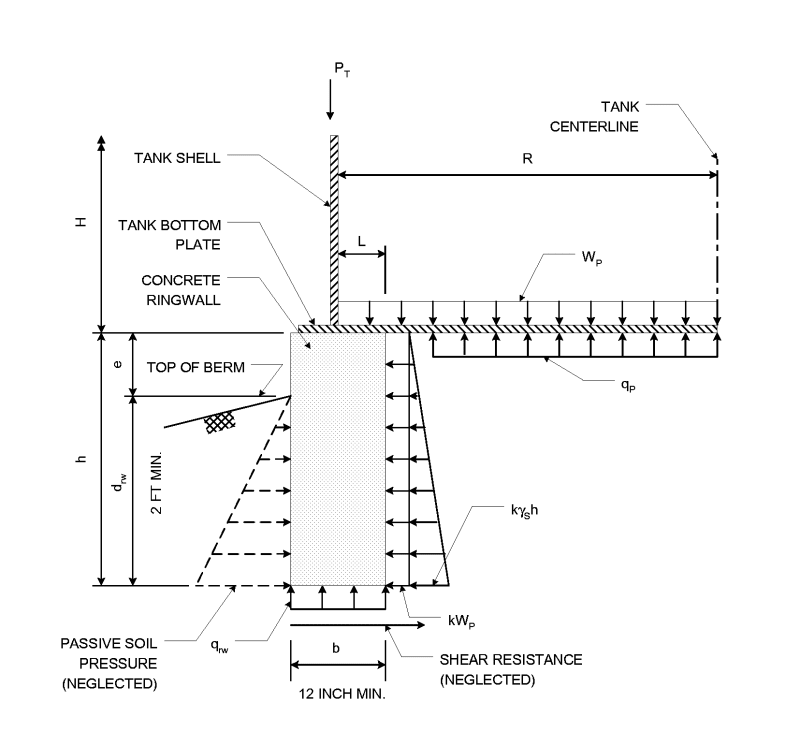

Yes, I already design the ringwall with PIP STE03020, SABP-Q-005 (Saudi code), and even ACI 318-05. I got same results of rebars numbers and actual soil pressure.
The soil pressure below the ringwall is exceeded the allowable bearing capacity even if I increased it up to the point it reaches the maximum width of 460mm. API 650 Annex B says, if the width of ringwall exceeds 460mm a footing beneath the wall should be considered. But the soil pressure below the tank exceeds also the allowable.
So, ringwall or ringwall with footing is not applicable for the tank/s.

Since ringwall or ringwall with footing are not the good choice, can you guys give me idea of what type of foundation can I use. And I hope a reference with example design. Thank you.
