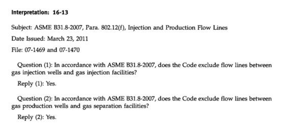

The bit that has always got me is that B31.8 is not officially valid for flowlines as it is two or three phase fluid. I think B31.4 has similar restrictions on its "official" validity for flowline design. They are though widely used for this service, in theory they don't cover well fluids (oil, gas & water mixture)
I'm not actually sure what you're supposed to use - B31.3??, but that sucks for pipeline design.
But definitely go for a pipeline code vs anything else and just be judicious on the design factor (nothing higher than 0.72) or corrosion allowance (1-3mm).

Well that's the problem with having two pipeline codes, one for gases and one for liquids.
What happens when you have a mixture of the two?? No one seems to know. There is a code case for B31.8 where it explicitly states it is not valid for flowlines with multi phase fluid.
I agree that the end result is often fairly similar, but I was just noting this anomaly with the ASME B series remains.
Your idea to use B 31.4 initially and then if your location class following B31.8 gives you a lower design factor then use that is a sensible way to go.
Then yes no overpressure allowance as there is gas in there remember.
Document it properly and get someone (client, regulator, other competent engineer) to review it and it should keep you safe from law suits and make it easier to sleep at night.

You're quoting from an old version. My 2006 version has that but not the latest one.
However the key bit is that it transport "liquids". Not liquids and gas co mingled or multiphase fluids, but liquids.
Like I said - in reality there is no other code commonly used or even signposted within the ASME B system for multi phase flowlines other than B31.3 and only a mad person would use that for a buried flowline so I'm not surprised that it is used and accepted. My point is that STRICTLY according to the letter of the code, you shouldn't and you therefore should use something like ISO 13623 unless some other authority who is approving the design, be that client or regualtor tells you to use B31.4. or accepts its use as a valid design code.
