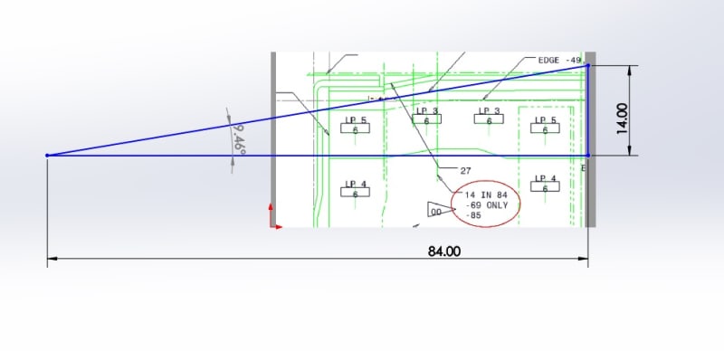

sheet metal bend call out 1
is it the slope of the joggle ? 0.08" in 0.48" makes sense; "14 in 84" not so much !???
Yeah. Lots of older stuff was done like that. I spend a lot of time updating prints from the late 30's to the late 60's.
14 in 84 means... 14inch rise over an 84inch rise... assuming those are inches. They probably had a machine or jig with a base of 84. See it a lot for lathe turned parts based on 12"
So trig it... tan^-1(14/84)=9.462 degrees.
Also looks like it only applies to items 69 and 85
See attached pic... looks close enough.
Thank you so much! @RoarkS very helpful. Yes this drawing was made in 1957.
Wow, clear as day now, wasn't that way to start.
