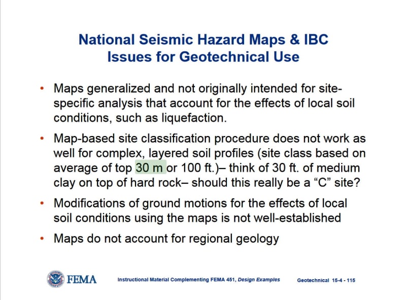

There is this from FEMA 451B - 2007 Link
PDF page 1483
Also consider that a VS30 shear wave velocity test can be performed either in bore holes or with geo-phones at the surface.
A google search for "FEMA 451" yields a host of complimentary FEMA 451 materials.
After reading this bullet point over again, it seems to suggest that Map-based site classifications were developed based on the top 30 meters but as stated do not account for local soil conditions.
Looking further at,
Link
the basis for 30 meters seems to be the availability of truck-mounted boring rigs to which, this is the approximate depth limit of the rig. PDF page 58 - Bucket Auger
