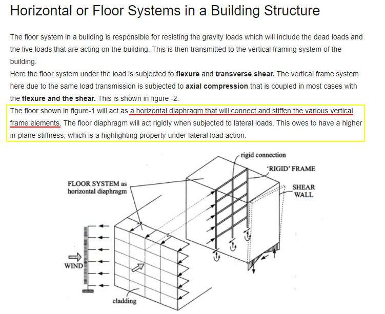

I think the illustration below provides a very good description of the function of the typical diaphragm, and its essence.
r13 - I certainly don't disagree with what you posted, but it feels a bit out of context. Showing a generic LFRS description with a diagram of a multistory moment frame building doesn't seem to fit the discussion of diaphragm considerations in light frame single family dwellings with pre-manufactured roof trusses.
I think in the generic sense, we can "qualitatively" call on the mysterious redundancy of wood construction to say that the load path can easily circumvent the roof diaphragm in many occasions. That's probably how most get away with it. There's also the fact that very few buildings have ever seen or will ever see their design lateral load, making it hard to "catch" the bad designs. But...the only really reliable load path is through the diaphragm (and specifically designed and detailed connections between them and the structure).
I am curios how you distinguish a diaphragm in a multistory moment frame building and a wood frame building (assume properly braced), aren't they function the same manners - deliver/receive the loads, passing the loads to the jointed framing members, and stiffen the jointed framing members in resisting the lateral load? Neither me, nor the article/illustration dismiss the role of diaphragm in any building that incorporates it in the design, rather, I like to call for attention to the stiffness of the diaphragm (for stiffening purpose), if you are employing one in your building system. Can building survive without diaphragm? Surely can, but not without a strong framing system.
They do indeed serve the same, fundamental purpose. That said, there are important differences:
1) Relative to a commercial structure, a residential wood diaphragm will be much, much less rigid. So much so that the the code asks you to look into that and tailor your design approach to suit.
2) A discretely braced (trussed) horizontal diaphragm is all but unheard of in wood frame, residential construction.
3) Chords, collectors, and their attachment to things are much less "automatic" than they tend to be in steel and concrete structures where, to a large extent, you "get that for free".

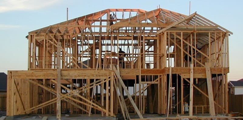

r13 said:
I can only think of the diaphragm is indispensable in the match box structure that consisted of walls and slabs only. I could be wrong though.
An unsheathed wood framed building is a good deal less stable than a wall and slab system which will have some, inherent rigidity at the joints. Imagine the situation shown below but without any sheathing or temporary bracing. It's truly just a heap of sticks.
