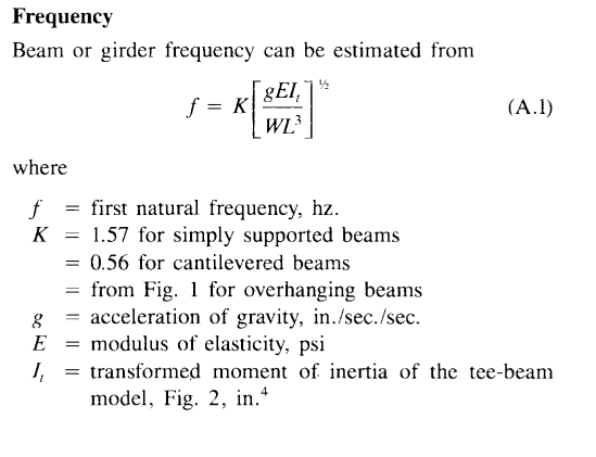

I would check the natural frequency of your structure. If you use ASCE 7 paragraph 12.8.2.1 I am getting 1.87 hertz for steel moment frames with a 40 foot height. I have not done a lot with vibration in steel but with concrete ACI recommends being 0.5x lower or 1.5x high on the frequencies.
You also need to check the beam's natural frequency separate from the entire structure.

evo10: in Autodesk Robot it is quite easy to do the whole building. Then I checked also locally whole floor (level). Then I checked single beam (using procedure from ArcelorMittal for composite decks/beams). No matter how I deal, I get values which are dangerously close to what the machine will impose.
