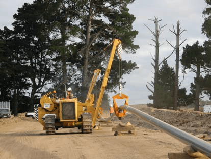

The welded pipe string is lowered into the excavated trench using side-boom cranes. The no. of cranes shall be decided with a calculation,the stresses developing shall be elastic for the deformed shape. That is, the lowered section in the trench, lifted portion and remaining section laying on the supports ,the stresses shall be kept elastic. The following picture depicts the concept.

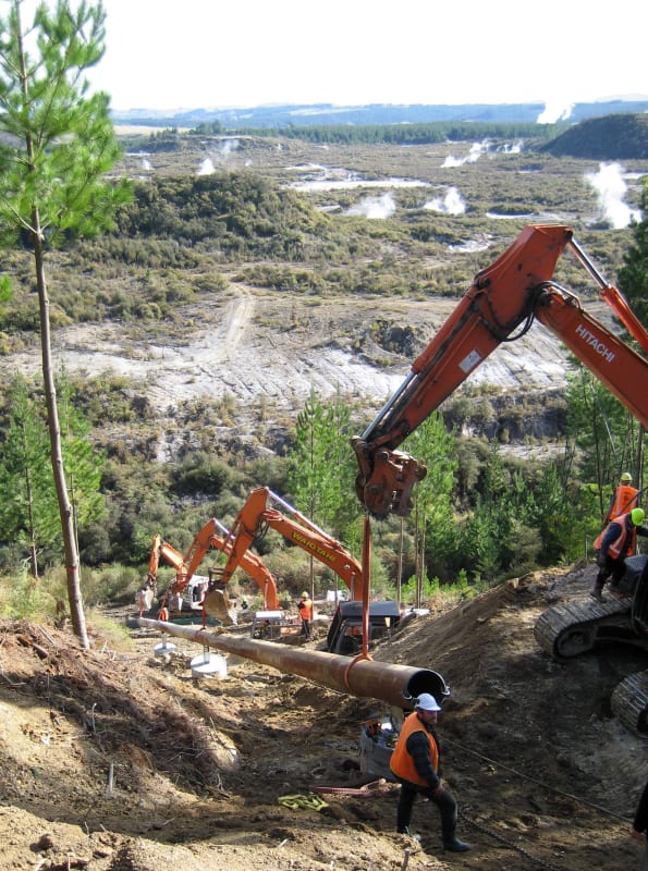

Two lifting points is absolute minimum. I've never seen a pipeline installation using two lift points from a single hook. You really need at least three and preferably 4 machines
12" thin wall you probably want about 25m between lift points.
Distance between pipeline and centre of trench - about 5m max, especially with only two lifting points.
why cranes? A 12" line like this should be within the range of some decent 360 excavators, but side booms or pipe layers are made for this job.
