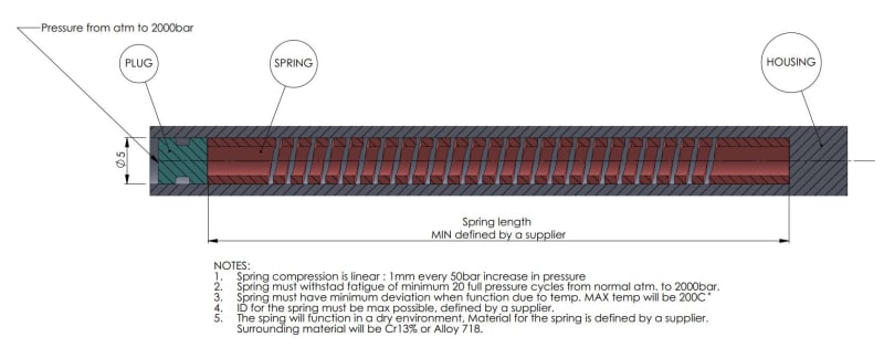

Hi there,
I'm looking for some solid material that can change its shape or geometry under pressure. Let's say i have a solid piece of a sample with a diameter 10mm and length 100mm. The sample is placed in a pressure chamber and pressurised from 0 to 2000bar. Every 50bar the sample is being shrinked linearly 1mm in length. When the pressure is bleed off the sample comes back in its original length of 100mm.
Thanks for advance.

We were looked at the Bourdon tube pressure gauges. It would be a perfect solution but we are limited by the space we have. I attached the drawing we prepared for a spring manufacturers. We basically want to see on other solutions to replace that spring. We looked at the helical bourdon tube design but couldn't find a supplier who are capable to make such a small helical tube to withstand 30ksi pressure.
Use stacked bellville springs. Use a small diameter piston rod so that pressure acts on a smaller area and the piston compresses the springs. You could use gas pressure rather than a spring, but then temperature will affect calibration.
