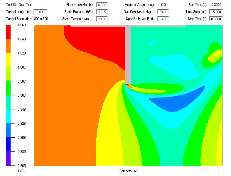

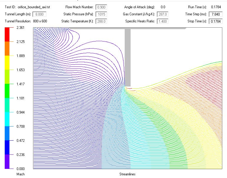

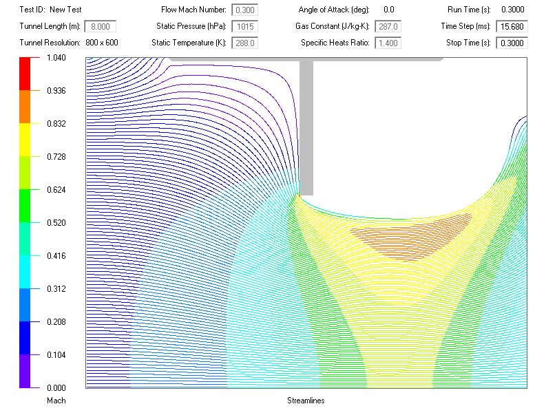

Just for grins i ran a couple of cases in a 2d windtunnel simulator. it doesn't allow for a completely enclosed orifice plate, but these results are axisymmetric around the lower x axis.
At high m values (I didn't bother running M>1 for obvious reasons) there's a big stagnation zone in front of the plate, and a huge one behind
This leads to a hot spot on the front of the orifice plate and a cooling effect behind
The same effects are present at lower speds but there is less temperature differential

I used microCFD but it is indicative only, an educational tool rather than a full blown simulation package. It won't go down to .0014 M or up to 2800K, and doesn't do heat transfer.
