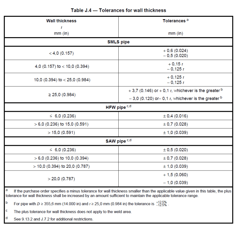

API 45th edition calls out a wall tolerance on page 145 table J.4
it simply states
wall tolerance + - 0,7 (0.028)t
should I do a calculation here based upon my given wall to come up with a wall tolerance? If so what is the calculation?
OR
Is it my wall + or - .028
BTW my wall is .375 and pipe diameter is 16" HFW

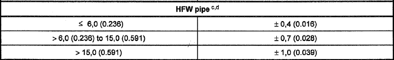

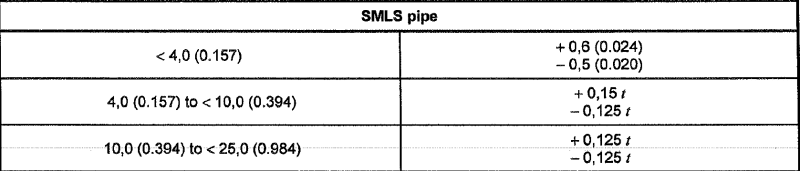

Not for HFW pipe; the SMLS pipe tolerance shows what would have been written if there was a calculation to be done in the second and third rows, compared with the first row:
However, the HFW pipe section shows no inclusion of the pipe wall thickness, so it's an absolute tolerance:

API SPECIFICATION 5L (45th edition) page 145 table J.4 I think self explanatory.
Tolerances defined as a percentage of t ( t is specified wall thick.) ,for SMLS pipe having wall thickness t > 4mm or 0.157 in.
Pls look to the notes a,b,c,d for additional restrictions.

Those tolerances are absolute numbers not percent of t.
if the tolerance defined with ( say + 0,15 t ) , it is clear that 15% of t or , 0.15*t ..
Yes, but as quoted, t convention is only given for SMLS. He has HFE, so those are absolute.

First off I apologize, I stated 45th ed. read wall tolerance + - 0,7 (0.028)t
When in fact 45th ed. did NOT have a t for HFW pipe.
So given the response above... that being absolute ... .236 to .591 wall would carry a tolerance of + or - .028
ie; .236 would calculate to + or - 11.8%
.591 would calculate to + or - .047% Yes Less than 1/2 of 1%
Generally tolerances are in the 12% range on all wall based upon API History.
In my opinion these tolerances do not seem correct and that is the reason I wrote the question.

How so? In the one example in the table where the SMLS tolerance is a percentage of the wall thickness, the percentage is 12.5% to 15%, which is higher than relative tolerances you calculated for HFW
