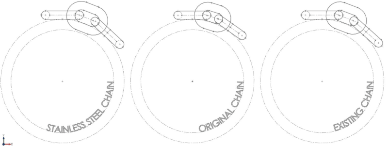

Hi all
I am completing a design check for a lifting chain idler pulley. The client is wanting to move to a stainless steel chain which is of slightly different dimensions to the original chain. I am struggling to find design guidelines for the design of this type of pulley. I gather this arrangement puts the links into some level of bending so guess there is a guideline/rule-of-thumb around the pulley diameter to link pitch ratio.
Note this is a lifting chain, not a roller chain or leaf chain. Perhaps now an unusual application, however this is a 1940's era design.
Images of the parts as follows:
Keen to hear peoples thoughts / experiences on this.

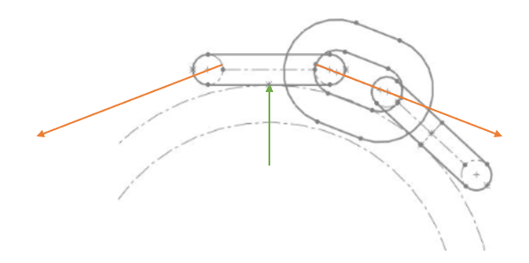

Yes I agree the chain only contacts the OD - so long as the groove is deep enough. However you will see in the sketch below that the links which wrap around the OD are subject to minor bending in addition to tension. I would have thought there would be a strength reduction factor, or a minimum diameter to be applied?
The Westinghouse code formula would give you the minimum diameter for the link bar stock assuming only bending stress. It accounts for fatigue.
Add the tensile stress from the load. Then you should have a good idea of what a given chain can handle. Might be good to make a Mohr's circle for the situation.

Load sheaves appear to be designed to not put any bending forces on the links. So it seems rather a non-issue.
I disagree. The links in plane with the pulley are in pure tension as you say, however those perpendicular which sit on the pulley OD are placed in bending as per the FBD below:
Some guidance on allowable is given below, which in this case the client is satisfied with (we have lots of margin on WLL), however this is for alloy chain so strictly speaking shouldn't be applied to SS chain. Also it doesn't provide any of the theory behind it.
My point was that if you look at pictures of actual load sheaves those links lie on flats, not curved surfaces.
