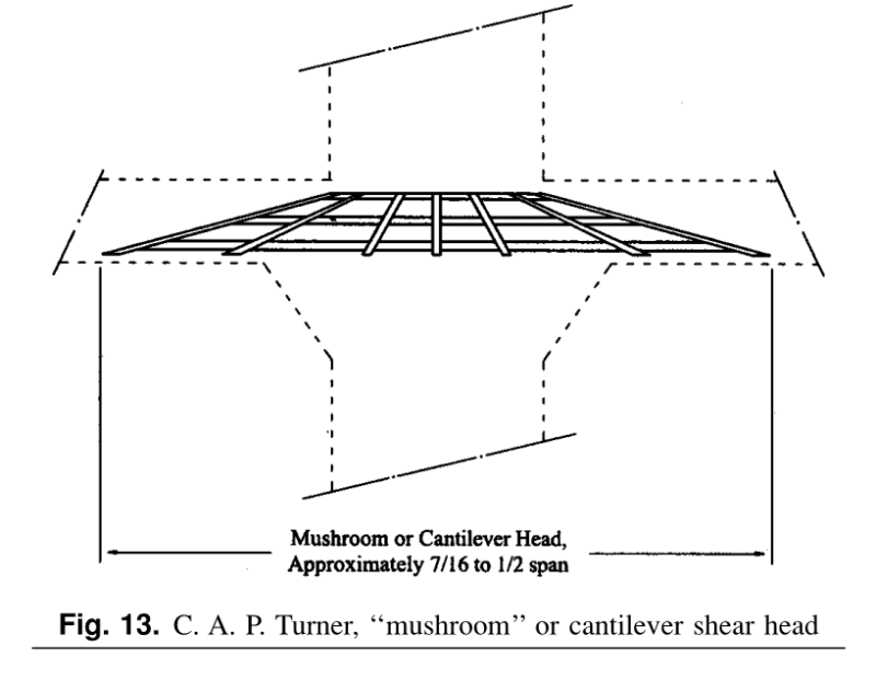

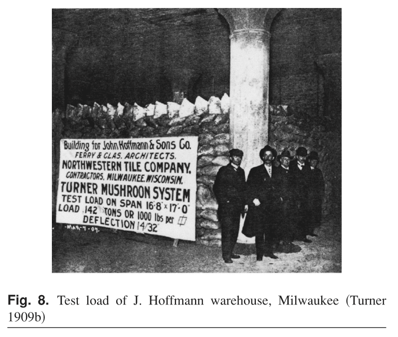

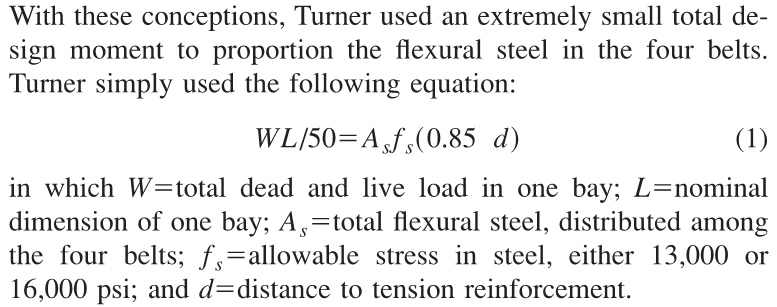

This appears to be a C.A.P Turner Mushroom System of Construction. A somewhat infamous system dated back to the early 1900's. Early pioneering flat slab design was somewhat controversial, right up to the 1970's. Many competing systems were patent-protected and design methods were held closely.
The 'cantilever' reference you refer probably is in reference to what Turner called "mushroom" cantilever shear head:
Turner's 4-way 'belt' reinforcement system was based on extremely low total design moments:
Interestingly, many of his floor systems were load tested to very significant over-loads:
