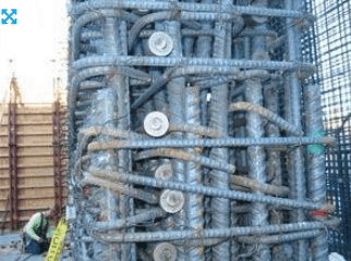

When congestion of reinforcement is considered (see below), it is understandable why engineers might consider using higher yield material. There are some dangers, however, as high strength steel, with our current technology, tends to be more brittle and does not have such a well defined yield point as lower grades. Bars are more likely to shatter when bent too sharply or too often. Also, it becomes more tempting to over reinforce a member with 100 ksi steel than it does with lower grades.
