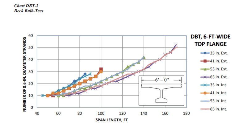

I have a bridge replacement where we are planning to use PCEF bulb tees. As an alternative (looking to shorten construction time) we are looking at a beams with an integrated deck (NEXT, Deck Tees). We have spans of 110' so the NEXT beams are out. Deck tees can go to 140' according to the charts.

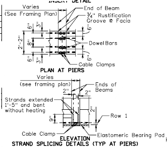

If you can not go to deeper girder, you may go with full continuity with wide in-situ integral crosshead. Our group in past constructed such a bridge some ten years ago. The following picture depicts the set up ( taken from CEB Bulletin 29 Precast concrete
bridges )
That an interesting detail. Was this because of the end stresses? Seems like it would require some temporary supports to support the beam ends until that end its constructed. I'm trying to simplify and shorten construction, not lengthen it!

What's curious is that these beams are rated per the design charts up to 140'.
The charts are for HL93 and I have the no. strands that the PCI table says I should have (30). It doesn't say however if the beam chart is simple span or made continuous. The beam works as a simple span. It's when it's made continuous that it proves challenging. One solution is to just make them simple spans if I can work out a link slab style detail since I'm trying to avoid joints.

That system adopted to keep vertical clearance and to utilize the existing precast formwork and bed .It is true that, it will require temporary support.
If you can go with deeper girders, as far as i see, you will need just a continuity slab. The system is essentially simple supported for the girders.
What is the details of pier and abutments?

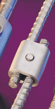

Sorry back on topic, we had to splice bars coming out of the top of box beam at piers once and used a quick wedge mechanical splicing system. Might work for your situation.
