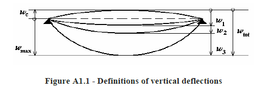

EN 1992 section 7.4.1(4) states :
"The appearance and general utility of the structure could be impaired when the calculated sag of a beam, slab or cantilever subjected to quasi-permanent loads exceeds span/250. The sag is assessed relative to the supports. Pre-camber may be used to compensate for some or all of the deflection but any upward deflection incorporated in the formwork should not generally exceed span/250".
The code clearly states that span/250 limit should be compared against deflection due to quasi-permanent loads( including the effect of creep and shrinkage of course) and figure A1.1 of EN 1990(see the attachment) shows some detail of deflection considered in Eurocode. I am confused in what way to stablish long term deflection check using Eurocode.
Is this the figure that you want to post?
That is correct HTURKAK.
Please be more specific.. If you want to calculate the long term deflection pls look to (7.4.3 Checking deflections by calculation ),
If you want to omit the deflection you should look to the requirements stated (7.4.2 Cases where calculations may be omitted ).
If you have a specific real question, pls share more info. to get specific respond.
If you're asking what are w1, w2 and w3 in the figure provided by HTURKAK, then they are the deflection due to permanent loads, deflection due variable load and deflection due to long term change of the deflection.

-If you are looking for long term deflection; you are expected to use β =0.5 and loading will be Quasi-permanent load (QP) and you shall consider the effect of creep and shrinkage,( (QP) could be taken as the dead load plus 25% of the imposed load for housing bldgs.)
- If you are looking for short term deflection ;you are expected to use β =1.0 and loading will be accidental load or standard CH value and you shall add the effect of creep ( interpolate the long therm effect considered for quasi-permanent load with loading age ) and shrinkage,
