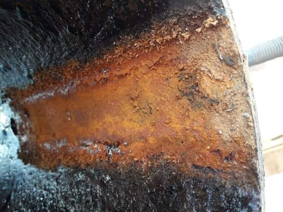

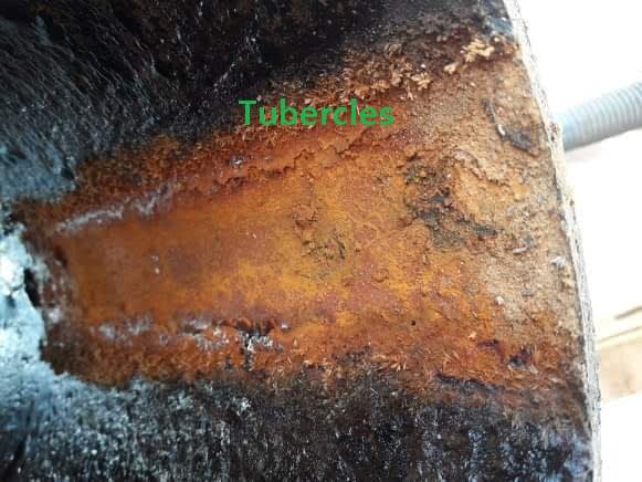

Look to the following picture to see wath we have found inside pipe (visual investigation) before acceding to the analyses:
My priority now is to identify failure cause based on the mentionned chemical analysis and it is clear that there are something strange with that composition.and i want to know your comments on it and if there any standards can help me to evaluate the degree of corrosivity.

From your photo, as being high corrosive water in an oil&gas facility, it seems that the flow in your pipe pipe is low and you are in presence of a microbiological corrosion caused by ALWC accelerated low water corrosion, because of that orange colour inside your pipe. Maybe you need some kind of biocide injection and for that reason as Dhurjati Sen, said contact Thermax, Nalco or Baker Hugges, for sure they could be of help.
luis
There are lots of other microbes than SRBs that you can have trouble with.
The corrosion looks to be at the water/air interface when there is just residual fluid is sitting in the bottom of the pipe.
Looks like a biocide and/or inhibitor is in order.
With that level of Cl don't fool around, once it begins corroding you can get a lot of damage.
For the water corrosivity, try running a CO2 corrosion prediction model. The chloride is a pretty average value and not unusually high.

Good thought Steve, I am not sure how acid that amount of CO2 will drive it, but it might be a lot lower than you think. Especially if the only samples that you have ever measured are at ambient pressure.
I can see Fe tubercles in the attached pic.

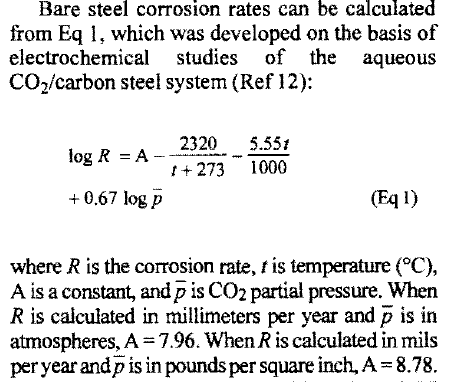

Well, for sure increasing the partial pressure will decrease the pH as the solubility will increase. However, from corrosion point the pH is a strong factor as it complete the electrochemical reaction. the low pH indicates the high H+ in the stream, which will act as cathodic reaction.
maybe this formula will help.
It doesn't take much bicarbonate to keep the pH up, and the OP hasn't given much of a water composition. The good old de Waard - Milliams equation was fine in its day, but things have moved on a great deal since those early times. NORSOK M-506
