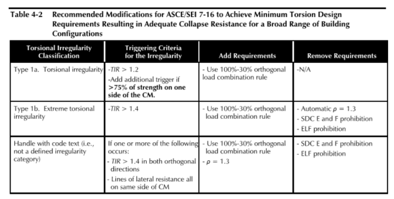

As others have pointed out, the torsional irregularity ratio can be thought of as an index to measure building sensitivity to torsion. Sensitivity to torsion is unaffected by the magnitude of building drifts. That said, it is likely that buildings with minuscule drifts will have increased collapse resistance over buildings with large drifts. The redundancy factor trigger is meant to increase the collapse resistance of torsionally sensitive buildings, but it's a bit of a blunt instrument since research has found that it's not necessary for all torsionally sensitive layouts. Some changes have been proposed for ASCE 7-22 based on the analytical studies performed in FEMA P-2012 (see below) that would eliminate the redundancy trigger for most buildings in favor a more refined approach of applying the 100%/30% orthogonal load combinations to capture torsional effects. There are also proposals to eliminate the ELF and SDC E-F prohibitions if the additional requirements are adopted.

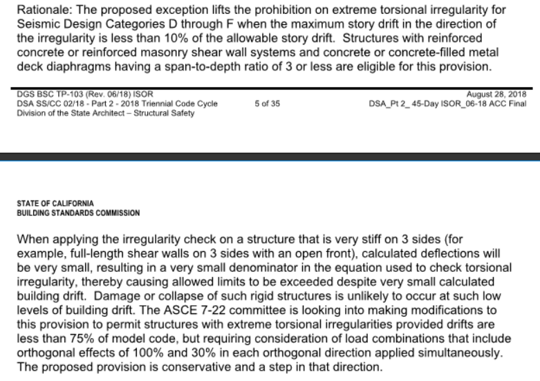

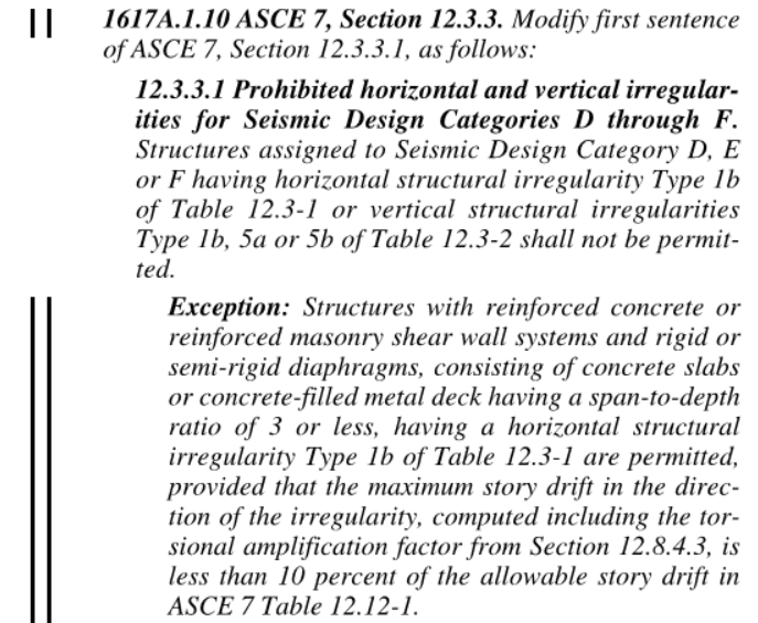

I also want to point out that some jurisdictions may have already modified the requirements in some form, so it's worth checking out depending on where your project is located. For example, DSA (the regulatory agency that oversees the design of public schools and essential service buildings in California) has already adopted the following changes:
Deker, that is very interesting! Too bad it will probably be 10 years before we can apply the 2022 ASCE code. Our client is Department of State and we still have to use the 2010 version. Building is overseas but US federal property so we apply Overseas Building Operations code, which is essentially just ASCE 7-10.
