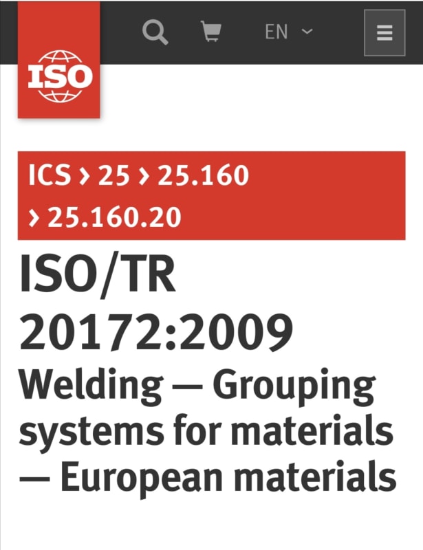

hello guys ISO/TR 15608 group 1
DSRED
May 26, 2020
21
GB
hello guys
ISO/TR 15608 grouping system for aluminum and EN ISO 15614-2
can any one explain how to use these standards and how to use them I have them both but would like some input on how to use these correctly,
Get also TR 20172 (or 20173, don't know by heart). That'll be more helpful than the 15608.
Kingnero
Thanks kingnero
