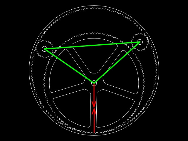

I want to use an inner/outer gear couple to replace a very large ball bearing, mostly radially loaded (it is a wheel hub)
Because of the load direction, it seems wise to increase the pressure angle, as it puts the load forces more perpendicular to the tooth surface and also because it increases the radius of the tooth profile, hence increasing the Hertz surface of the teeth contact.
Increasing PA comes at the cost of reducing the teeth height, but who cares when the torque transmission requirement is low.
To put a few numbers: ring gear diameter 240mm, inner gear 190mm. Aluminum 7075. extreme radial Load: 4000N
The outer ring gear is also guided by 2 other smaller gears (32mm diam - this probably determines the minimum tooth module).
Question is how to select the optimal tooth design for the case ? Would there be a problem to use as high PA as 45 degrees ?
You may wonder why I don't simply use a large roller into a ring. But under some conditions, the radial load may decrease to the point where the friction would not suffice for the little torque transfer needed, so I really need teeth.
Thanks ! Pierre

I calculated the Hetz surface and pressure for a 6mm thickness - R=70mm (curvature of the tooth profiles, nearly the same for inner and outer) and found po = 467MPa - which might be acceptable for extreme load on al 7075 ?
Just a picture to show the internal gears attached to a common green frame, and main load in red.

Application is a wheel hub for a recumbent bicycle (there will be sprokets attached to the ring gear). The idea is to have the crank pass through the hub, above the large inner gear (an alternative configuration is to have the crank pass through the wheel axis, but this makes it positionned too low, thus having pedaling unconfortable)
" as the pressure angle becomes larger there is more radial force" .. due to the applied torque. In my case, the torque is relatively small, so the radial force resulting from that torque will be generally much smaller than the external radial load (due to the weight applied on the wheel through the hub).

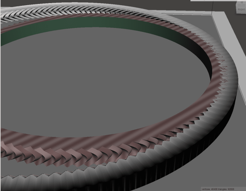

Before I contact manufacturers, I also need to extrude the 2D gear profile. For a herringbone gear, I should extrude with a linearly variable angle first going up, then down. Instead of linearly varying, I could use half a sinevawe function - (instead of the triangle used for herringbone), to avoid the sharp transition ?
If don't think the CAD packages I sometimes use (Qcad, Freecad, Design Spark, skechup..) can help me with this kind of funny "variable angle" extrusion.
to draw gears correctly you need professional gear software, there is a bunch out there, and not that expensive, or research how to draw it manually with cad, but based on base diameter.
the animation you drew, I am afraid will not suffice. good luck
I used a hobbyist gear generator ( Now I checked the .dxf file, and it seems accurate, the teeth profile is approximated with segments, and I measured there are enough segments to limit the error to less than 0.005mm.
Anyway, I am interested in a low cost professional gear soft if you can recommend me one.
Finally, as I could'nt find a suitable CAD soft for variable extrusion, I tried to produced the .stl from scratch (in VBA Excel / I've already played with that some time ago).
I will try to have them 3D printed in Nylon, to check how it behaves. I had a quote for less than $100, but it takes a while..
