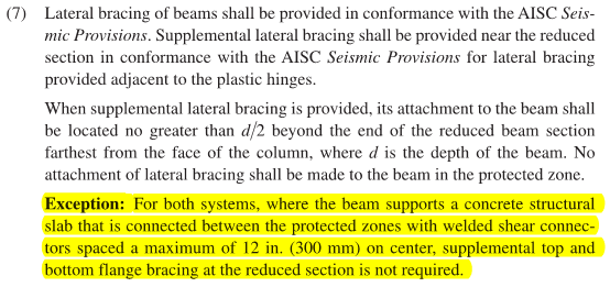

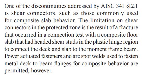

This is a must have, free reference for this kind of stuff if you don't have it already. Link. The clips below are taken from that reference and, I believe, answer at least part of your question.

2) At special moment frame beams, the salient issues are these:
a) In the past, premature fractures in the plastic hinge zones have resulted as a result of stud welding embrittling (sp?) things. To address this, the plastic hinge zones are now "protected zones" where the studs are not allowed. So these local areas must either go without deck fastening or, as described in the clip below, the fastening must be limited to less detrimental methods such as powder actuated fasteners and spot welds. I would have to think that the latter option is the better in most situations.
b) For the purposes of capacity design methodology, there has been some concern that having composite flexural capacity by accident will cause designers to underestimate the capacity of the beams to be used in the over-strength design of other aspects of the system. As described in the second clip below, we deal with this by placing restrictions on the kinds of connections that are allowed when a structural concrete slab is present.

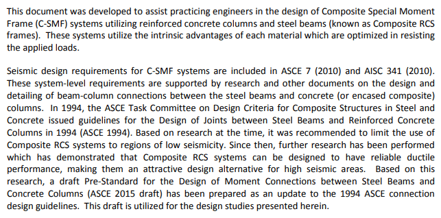

I am assuming that you are using a conventional SMF system. As composite action is taken into account when designing for C-SMF/OMF, composite moment frames see AISC section G. Also note that the power-actuated fasteners up to .18" and for deck support only. We have them provide arc welds where studs are not permitted as even letting them use fasteners in the area can cause them to think they can put them anywhere. We also still provide bracing at the protected zone even when we use studs.

thanks sandman21. Yes, I was referring to the conventional SMF system. Thank you for leading me into this. So it is C-SMF where we can use the composite action of steel beams and reinforced concrete slab to resist seismic forces but I just want to clarify (sorry, I hadn't mentioned it before) if this is applicable if my column is just pure steel? What I mean is that for columns that are not composite? From what I read, this is for composite or reinforced concrete columns only?

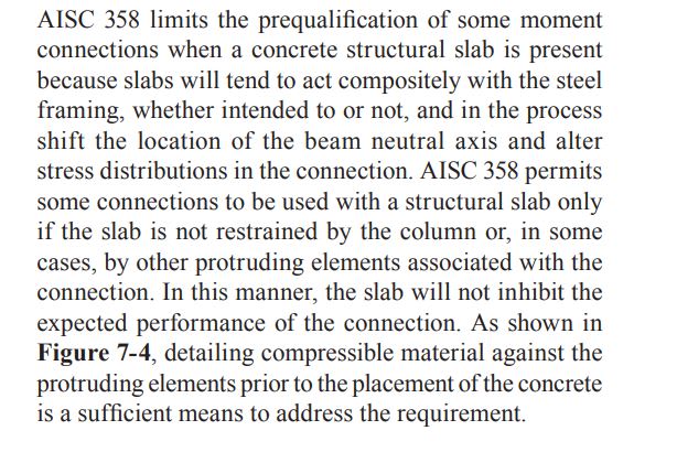

..concrete slab is present and should make it such that the slab will not inhibit the performance of the connection which can be achieved by using compressible materials around the connection.

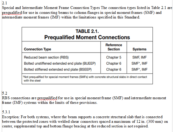

The compressible material requirement is only true if the pre-qualified connection requires the the materiel.

Prequalified connections per AISC 358 with notes -
if the (Longer span / Shorter span) ≥ 2 is satisfied

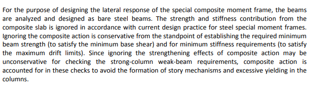

I just want to remind the RC beam design for SMRF; Under reverse load during a large EQ, hinge development affects both the top and bottom of beams and leads to cracking and spalling of cover on the top and bottom of the beam . In order to improve ductility, confinement of the concrete core is necessary. For this reason, closely spaced transverse steel needed.
The same reasoning is valid for composite action of beams for steel SMRF. During a large EQ event, the concrete topping around hinging zones of the beams will crack and composite action will deteriorate rapidly in subsequent cycles. That is, one can not assign a hysteresis loop for composite action.
I understand that the standard is allowing composite action for steel beams that are part of this moment frame are only to resist gravity loads to justify the SWAY MECHANISM and STRONG COLUMN -WEAK BEAM requirements.
However, totally ignoring the contribution of composite action for the link shear strength should not be reasonable ...The overstrength produced by the composite slab effect should be considered to estimate the maximum forces that the shear link imposes to the other structural elements.
