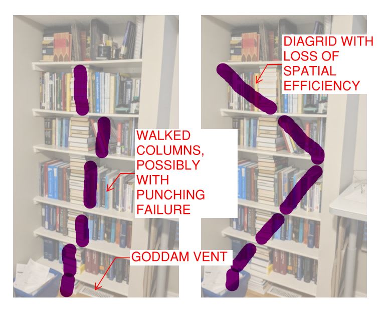

Thanks. The shelving is a built-in that came with the new house we picked up in May. It's a bit magical in that:
1) It exists in my office and nowhere else.
2) It fits ALL of my structural books into one shelf, albeit barely. It's always been at least two crappy Ikea cases in the past.
3) The shelving is bizarrely sturdy. 5/8" deck and the end ledger that you see in the pic runs all three sides so it's like a high aspect ration, three sided plate. Bitchin'.
The book-column being off center to dodge that vent at the bottom bothers me immensely wrt to the asymmetry of it and the potential beam uplift on the left side. When time permits, I'll do it better, as I should have from the start.
jayrod12 said:
I was going to comment on the 2 span as well, I assume those must be books he's already finished.
Sadly, no better than 20% there either. The unfortunate books chosen for the strut were chosen as follows:
1) Books that I thought that I had a very low probability of getting to pre-retirement.
2) Books thin enough to allow for a tight shimming between shelves.
3) It turns out that this works best with some degree of post pre-stressing. The thin paperbacks work well in that regard.

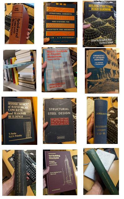

dauwerda said:
Not to hijack the thread, but what would be the top 5 books for general structural engineering you would recommend, KootK?
See the attachment. The best that I can filter it down to is a dozen, unordered. My criteria:
1) Rocked my world with some genuine insight on fundamental principles. None of that "how to" BS.
2) Not commonly found on an EIT's bookshelf.
3) Usually hits on some aspect of whole building schematic design, not just elements.
4) Usually, but unintentionally, written by a legend their space.
5) Readable and practical. Not so mathy that it's painful to read or digest.
6) Written by someone that I consider to be a "great explainer". You'll note that Paulay, Galambos, and Lin each have two entries in the dirty dozen. They're that good. I'd read their laundry lists if they'd make them available to me. You know, from beyond the grave.
Sadly, I've yet to find a wood book that's really rocked my world. Maybe we should write one.
One could probably procure most of these for under $100 on Ebay.

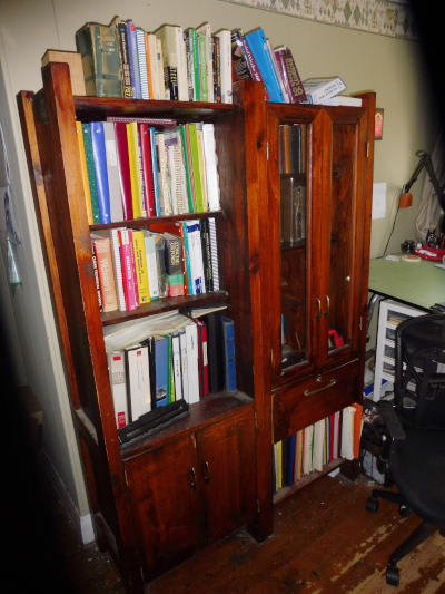

This is the pine wall unit I designed and built for my computer room. The rear wall and the shelves are solid wood, and the shelves are screwed to the rear. The wall unit is two pieces, make it easier (feasible) for me to move it upstairs from my workshop. The solid rear wall places the centre of mass at the rear of the bookshelf, where it belongs. I had to add steel brackets underneath the bottom shelves, because I did not run the dadoes all the way across. Live and learn.[ ][smile]
The windows on the doors are UV[ ]resistant Lexan. This provides UV[ ]protection to my collection of old books.
My textbooks are scattered mostly randomly around the room, but lots are on this shelf. My Machine Design textbook (V.M. Faires) is there, covered in significantly more shipping tape than the 21st edition Machinery's Handbook I bought in college. My 26th edition is in much better shape, since I was on CAD by the time I got it, and I had access to the internet, and a CAD library.
