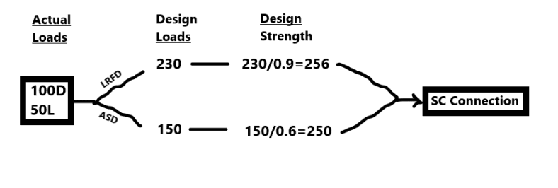

Veer007,
I hope the chart below can eliminate the confusion over designs based on LRFD and/or ASD.
Note that the SC connection will be tightened per the capacity of the selected beam, which in term is based on the required strength from design (the nominal strength).

Up here in Canada I believe the SC design would still be for the 150, not the 230. The 230 would be used for the ultimate limits states checks like bearing, block shear etc. For SC as I indicated in the other SC thread is for service level loads, therefore unfactored.
Perhaps the LRFD design in the US is different than the LSD (Limit States Design), but I can't imagine it be significantly different.

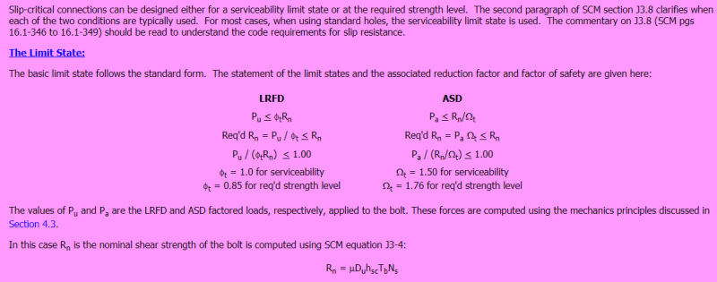

There's negligible deformation in a slip critical connection. That's the point. The intent is that it doesn't move or deform under it's design loads, regardless of load reversal. However if the design load is exceeded and the bolts go into bearing, then you could have the standard yielding at the bolt/steel interfaces that you see on all types of bearing connections.
As retired has indicated, once the slip critical resistance has been exceeded, then you cannot call it a slip critical connection again without some serious re-working and repair of the faying surfaces.
jayrod's explanation is in line with this quote.
High-strength bolts in slip-critical connections are permitted to be designed to prevent slip either as a
serviceability limit state or as a strength limit state. The most common design case is design for slip as a
serviceability limit state. The design of slip as a strength limit state should only be applied when bolt slip can
result in a connection geometry that will increase the required strength beyond that of a strength limit state, such
as bearing or bolt shear. Such considerations occur only when oversized holes or slots parallel to the load are
used, and when the slipped geometry increases the demand on the connection. Examples include the case of
ponding in flat-roofed long span trusses, or the case of shallow, short lateral bracing.
