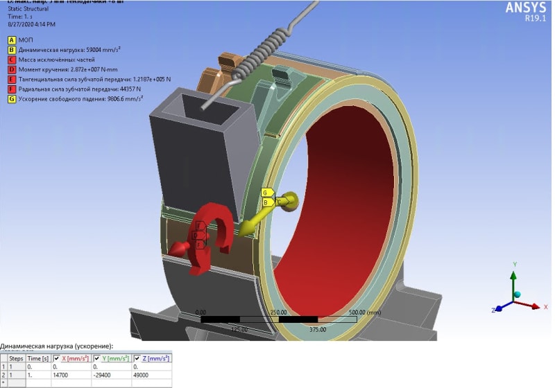

I am making stress analysis of an electric motor.
The problem is i have gotten the higest stress near the weld connection which is the reason why my construction is not satisfied the required safety factor.
The highest stress is situated at one fourth of the part depth (third picture) so i suppose if i calculate this cut by hand i will get much lower result.
I have no idea how i can try to reduce the stress. Currently i am changing the grid and if it wont help and i dont know what to do else.
Can someone advice me on what else i can do to reduce the stress at this spot?

assuming you are running linear FEA … then run non-linear FEA.
When you include the welds’ geometry in the model, you should make sure that the mesh is properly refined around them. Perform convergence study to determine the necessary mesh size in this region. Also make sure that welds are properly connected with the rest of the model.

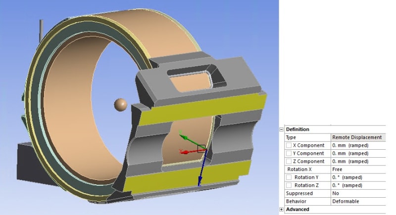

Can you show the whole model with boundary condition and load symbols ?
Could you please provide me with information how to make convergence study?
Refine the mesh in the region of interest and run the analysis again to see how the results change with denser mesh. Repeat several times until the difference will be negligible. You can create a plot of max stress vs element size to make it easier.
The recommended method of mesh convergence I've seen in most texts is to half the element size in the region of interest and check if stress changes <10% if yes then good, if no refine further. Looks like your weld is its own solid (non-coincident nodes with nearby structure)I can't say for sure how ANSYS connects dissimilar meshes, but in FEMAP/NASTRAN this would be a glued connection and I would argue that the stresses near a glued region are not accurate. I would typically do a hand calculation based on Blodgett's formulas for the weld and only use the FEM results near the welds for ballpark comparison.
Edit: I would also add that is a fairly good sized chunk of red you have there, could be something to this more than inaccurate weld modeling. Have you considered your part is yielding and you might need a bigger weld / better geometry? I would be uncomfortable using non-linear analysis to prove a weld good unless you are really an expert. Analyzing welds in FEA is an advanced topic. Another consideration, will you have repeated loads on this part? Fatigue could be of concern as well depending on use.
I made the grid smaller and larger and got a results that differ by 10%. But i need at least 40% decrease. Now I am trying to perform convergence and wtite results later.
Convergence is not a tool used to decrease stress results! Mesh convergence studies are used to verify the mesh is accurate enough for engineering approximation! Usually you will see stress results increase as your mesh trends towards convergence. Your part is likely over-stressed

There's a lot going on in his model … clearly area contact, modelling a weld (the weld material) is something I wouldn't do (I'd do some hand calc).
Presumably the material properties of the weld material are right ? and the local heat affected zone ?
There so many things we can't really see. Constraints seem to be a couple of arrows … which makes me think of fixed constraints, which is scary.
But the usual answer to localised stress peaks is NL (ok, material nonlinearity). Sure, you could do some "neuber" analysis with linear stresses (can you apply neuber to a weld ?).
I am a civil engineer so my comment might be inappropriate. I notice that your model assumes that the weld does not turn around the corner, which creates a sharp change, discontinuity, in the model. How realistic is this assumption? Can you modify the construction/design in a simple way rather than tweaking the model?
In addition to high stress in the weld, it looks like the pad on the shell is highly stressed in bending. If this isn't acceptable, make the pad thicker to keep the bending stress at an acceptable level.
To decide if it's acceptable, you need to elaborate on what you are trying to prevent. Are you designing for a single overload failure (collapse) or fatigue? If overload failure and you have a ductile material, plastic analysis is definitely the way to go. Do you have a safety factor against collapse you need to meet? Is there a deflection limit? These things are straightforward with plastic analysis. If you are designing for fatigue with welds, I'd stick with elastic and look into a structural stress method.
I'll also second the comment above about mesh insensitivity. The results must be mesh insensitive or else they are meaningless. Personally, I find rules of thumb like <10% change to be unreliable unless the analyst has significant experience. For a novice, I'd shoot for a much greater degree of insensitivity.
