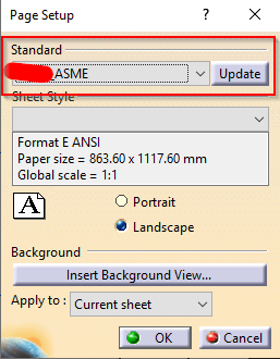

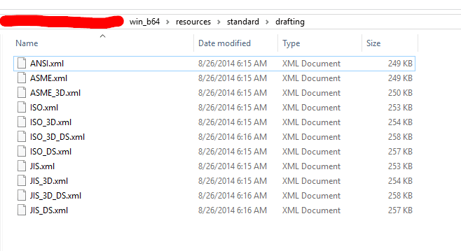

You have to drill down into your drafting standard and change the XML file values. They are in the CATIA install location or possibly in other folders depending on your companies setup or use of ancillary automation tools. These are the files that populate your drafting standard under file >> Page Setup >> Standard.

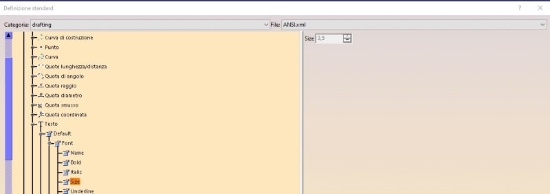

Hi!
Thank for your answer. What ha you used to edit the .XML file?
You can use default editor available in Tools-Standards when running CATIA in admin mode (/admin switch).
I have found it but I cannot edit it even in admin mode.
