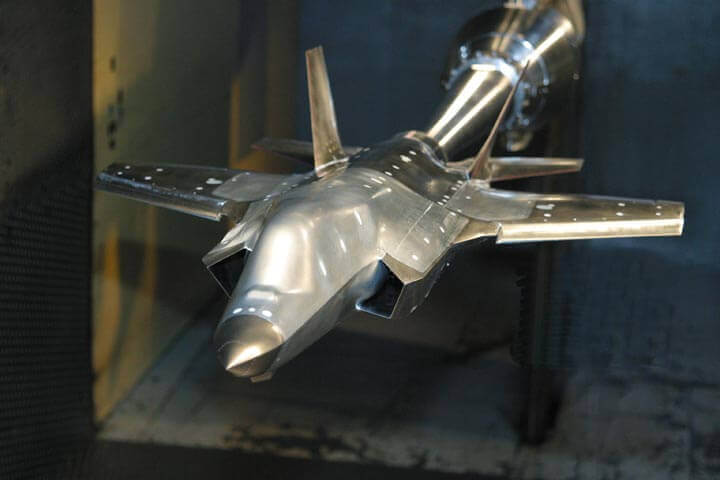

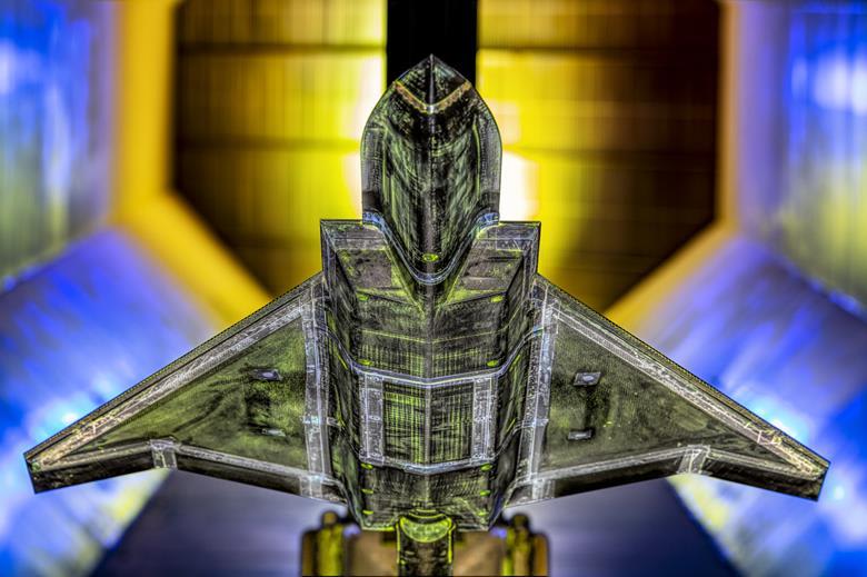

this, from Flight International, surprised me. It's a model of the latest UK fighter, Tempest. Appears to show the engine intakes as being blocked off, rather than allowing airflow into the engines ?
 https://files.engineering.com/getfile.aspx?folder=a388bc35-e363-4b51-bef6-8eab23cbfaf5&file=72546_tempestwindtunnelweaponsbaybaesystems_186297.jpg
Ummm
Is is a photo from an experiment or is it a project from art class?
Is there value in coating wind tunnel models with fluorescent liquid (help visualize the flow)?
This is more like what you expect to see.
Vents to represent the engine intakes, and suction in the support cone.
These are very small models, BTW. Probably less than a meter long (both this example and the "art" project above)
Some car manufacturers are happy to quote Cd with the radiators blanked off. There is some method in the madness, as it is a lot easier to initially correlate models with complicated bits blanked off, and then add the complications.

the photo was from Flight. yes, your 2nd pic is more what I'd've expected.
