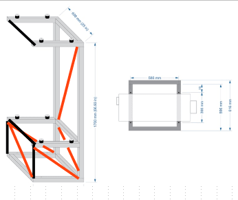

If I am doing it, I'll add quite a few members as shown in sketch below (Black - HSS, Red - rod/plate/HSS diagonal). The upper cantilevers may require kickers too. Do you think you can handle all calculation required? Although it is small, the concept is the same as a building frame.

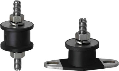

Of course I will do that. It will look something like this (the one on the left), except I'll need to use longer bolts on the bottom to pierce through the steel tubes and come out from below.

The off center weight creates a moment (rotation) about the center of the frame, which will resolve into a couple at the support legs. The net support reaction is the sum of effect of the weight plus the couple. See sketch below (Red - moment, force couple).

Dik, the vibration isolators have independent top and bottom threading so you can't really screw through them:

He should still add mounting tabs at the bottom
What's the reason for avoiding fastening through the steel tube? I dislike the idea of using mounting tabs at the bottom because of the off-center positioning of the vibration pads. More than half of their "supporting" surface will inevitably stay clear (no matter which direction the tabs are facing) and the tubes will end up resting only on the remaining portion of the pads.

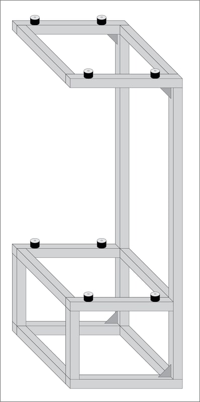

Following some of the suggestions provided in this and the other thread, I have updated my design to the following:
Not sure if this would be the right type (or size) of gussets to use, so if anyone has a different/better idea, please let me know.
Those gussets are installed as what I refer to as "can opener." The sharp ends are in the middle of the thin wall. In this case they perform no function as the rest of the structure is stiffer, but I've seen similar gussets just punch through.
Typical gussets would be cutting tubing to fit so the flat side walls have structural continuity.
