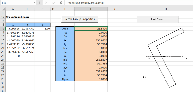

My section properties spreadsheet will calculate the second moment of area about the principal axes for a variety of shapes, and also allows shapes to be rotated and moved, so that the X and Y axes pass through the centroid and are parallel to the principal axes:
See: for more details and a download link.

Sure you can do it in CAD, or in most structural analysis/FEA packages, but I don't know why that is treated as the default approach when it is much easier and quicker to do it in a spreadsheet, which also provides much more convenient access to the results for further analysis.
Doug Jenkins
Interactive Design Services
IDS is correct, it is rather easier to use a spreadsheet. Hand calculation will enhance your understanding though. One question, on the spreadsheet, Ixyc should always be zero, correct?
For the rotated shape, with the XY axes parallel to the principal axes, yes, otherwise no.
One advantage of the spreadsheet, compared to using CAD or FEA, is that the formula for each property is displayed next to the result, so you can check it by hand (and also transfer the formula to other applications).
