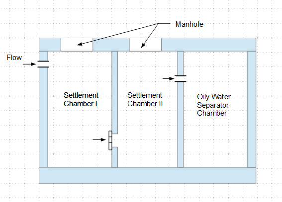

I think you can build a septic tank alike system. You'll need someone to calculate the process volume, and select suitable oily water separator though. You can use concrete, brick, or even the 500 gallon drums with piping in between.
Now that you have explained this further, one would think a small basin should suffice. Use a section of the basin for oil collection. The oil/water section should underflow into a larger section of the basin to collect grit. Let the basin overflow to infiltrate into soil. Remove the oil and grit periodically.
