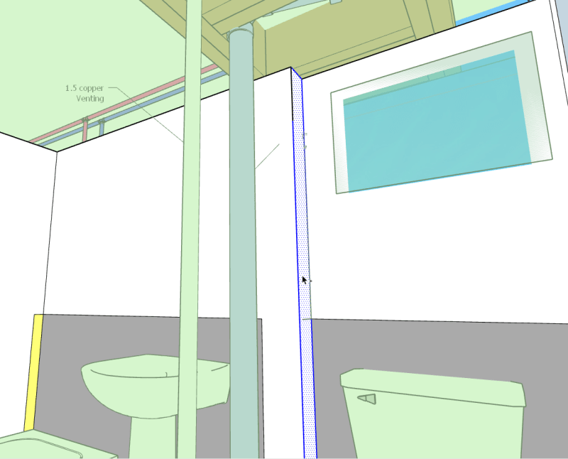

As you can see in the picture I am changing the position of the bath tub and the position of the sink.
After asking around here I have come to the conclusion that I probably have a drain and a vent somewhere in a wall that I was planning to remove (shown replaced with a pane of glass in the second picture)
The third picture shows what I am assuming is the drain that I would like to reroute in order to conceal it in the wall for its basement portion. Is it possible to install a fitting that would push the lower segment of the drain into the exterior wall? so I can hide it ?
I am planning to hire a plumber for this (not sure how expensive and difficult this should be) but before doing that I want an engineer opinion on the pros and cons for doing this
Any help will be much appreciated

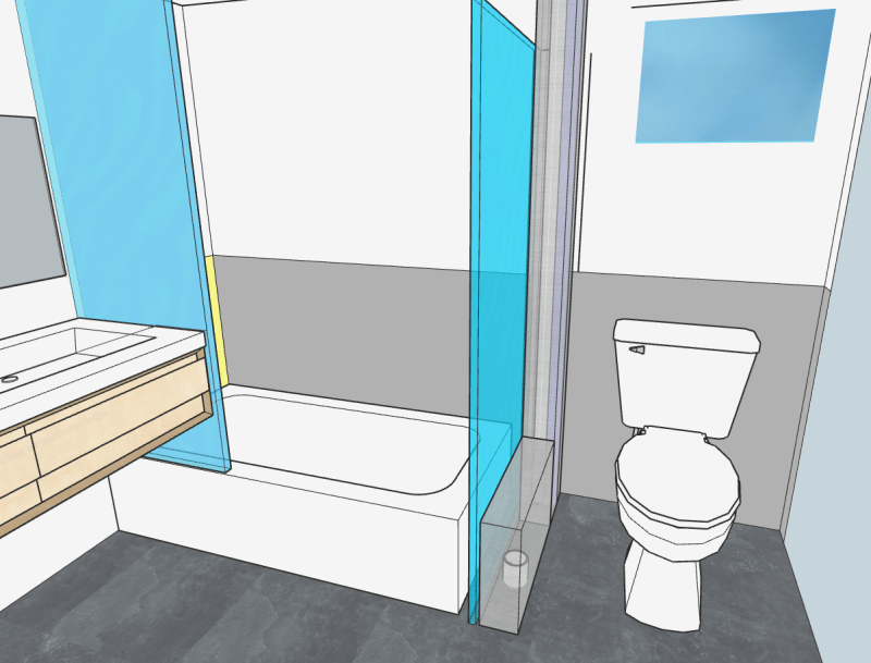

Here is the current layout
and here is the new layout
and here is how I believe that the drain is positioned
it also explains the existing wall between the toilet and the bath tub
this wall is blocking the light and it uselessly segments the space in the room

Existing route for the pipes
New route for the pipes
so basically I would like to runt the drain and the pipe along the wall and then when they reach the floor
reroute them back to enter the floor where they used to. I will conceal that in a box that will sit between
the toilet and the bath tub. (the brown box in the picture)
Each bend in the main vertical stack (you would be adding 2) will require a vent just below the horizontal portion - this is to ensure proper ventilation in the event of a clog due to the change in direction of the stack. However, this doesn't look like it will be an issue as there is already a separate vent line there that you are also rerouting (provided it is large enough in area to meet code).
Do you foresee any functional issues due to this re routing?

The last picture shows you that the bath tub is not reaching the pipes, it is too short and it leaves me room to build a box there to hide the entry points in the floor
I would be happy to make a vertical box to cover the pipes provided that they can be run along the wall vertically
There is already a niche there formed by the space where the toilet is installed, as you can see in the picture below (see the dotted surface)
That is where the framing stops because I guess the contractor was lazy and he did not want to relocate the toilet properly when they finished the basement
So my idea is to move the pipes there .

The end result should be this
Not sure if I want the glass between the toilet and the bathtub
There should be some magic that the installer should do in that grey box ...that if I decide not to open the floor to do the things properly
in which case that box won't be there anymore, just the vertical one that hides the pipes
