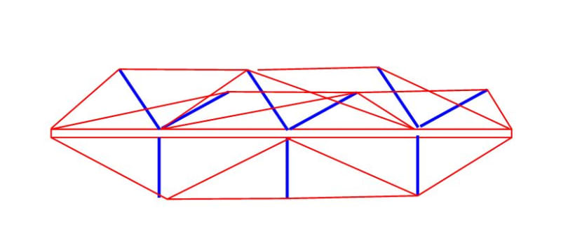

Maybe explore agricultural systems designers? The situation where I've seen similar structures is on farms where they 3D truss the pipe itself in a rather clever way. Even if your pipe can't be the compression strut, maybe it could be strapped to whatever is. See my sketch below in which I've butchered the concept pretty badly with my limited Bluebeam skills.

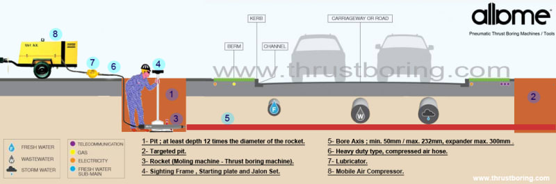

I will suggest ; thrust boring system which provides accurate horizontal bore beneath the road without trenching . You may leave 4 in sleeve pipe for future use for utility lines , communication cables etc .However the responsible authority will be asked to give permit and my opinion ,their approach will be positive.
You may search at your local area for the expert groups having trust boring machine. The concept is shown at below picture found at web:

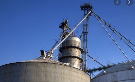

I thought KootK was referring more to something like this:
That's exactly what I was referring to.
