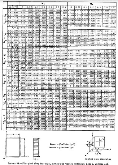

B.O.R Engineering Monograph No. 27. See column on the left, and illustration graph at the bottom left for the aspect ratio "a" and "b".

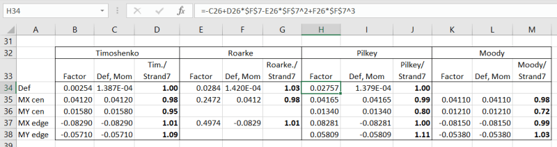

I have done a quick comparison of the Roark and Timoshenko tables with the B.O.R Engineering Monograph No. 27 (Moody) and W.D. Pilkey's FORMULAS FOR STRESS, STRAIN, AND STRUCTURAL MATRICES, compared with a plate/shell model in Strand7.
I looked at a rectangular steel plate, 10 mm thick, with a = 1.0 or 2.0 m and b = 1.0 m, with uniform load = 1 kPa, E = 200,000 MPa and Poisson's Ratio = 0.3

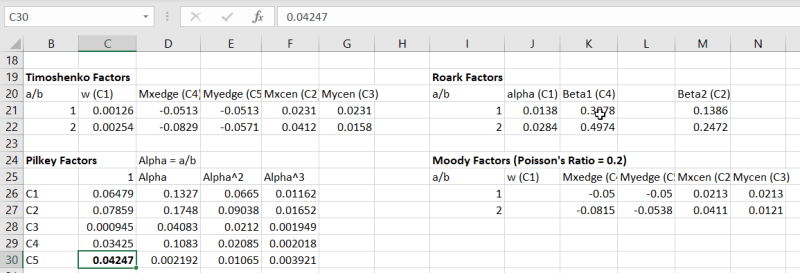

The factors from the four sources are summarised below:
Note that:
The Pilkey factors are given in the form of a cubic of alpha (a/b)
The first Pilkey factor for C5 (shown bold) is shown as 0.4247 in the text, but this appears to be an error
The Roark factors for deflection incorporate the parameter D, which is applied separately by Timoshenko.
The Roark factors Beta1 and Beta2 are to calculate stress, rather than bending moment.
The deflections and bending moments derived from these factors are shown below for a/b = 2, compared with the Strand7 results:
The results are:
Deflection
MX midspan
MY midspan
MX mid-edge
MY mid-edge
The results are reasonably consistent for deflection and MX values, but there are significant differences in MY, both between Timoshenko and Pilkey, and compared with the Strand7 results. Note that the Moody results were prepared for concrete structures, and assume a Poisson's Ratio of 0.2.

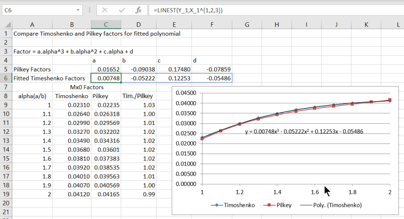

It looks like the Pilkey numbers are based on fitting a cubic polynomial to someone's data, but not Timoshenko's. I have fitted a cubic to the Timoshenko numbers for the central Mx, and get the results shown below:
The Timoshenko polynomial factors are very different from the Pilkey values, although they all have the same sign, and the resulting moment factors are all within +-3%.
Also note that if the polynomial factors are used outside the specified "alpha" range (1.0 to 2.0), the results are nowhere near the correct value.
Doug Jenkins
Interactive Design Services
I imagine whoever fitted the cubic to timshenko's data picked the four points where they agree and said "near enough" for the others (at least the cubic fit is conservative).
