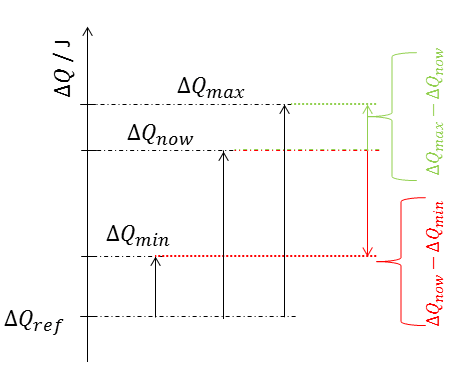

Hi everyone!
I'm new here and just registered since I thought this might be a good place to ask.
I'm an aeronautics engineer specialized in the fields of thermodynamics and fluid mechanics, currently working as a researchers.
This is also the reason why I feel quite stupid having to ask this question... [bigsmile] But I've been dealing with so many equations now, out of which this task is by far the easiest, but still got my brain completely confused on such a basic problem...
I want to calculate the heat content of a thermal energy storage, filled with water (liquid, no phase change). With this heat content I want to evaluate the state-of-charge of the TES. Thus I have a set of current temperatures, a set of lowest temperatures and a set of highest temperatures.
Let's simplify by dividing the storage in 3 control volumes of which I've got the temperatures. The total volume is V=1m^3. Material properties cp and rho are also quite exact in the range from 0°C to 100°C.
Now I've got three states (temperatures top to bottom):
- fully charged, temperatures, state "max": T_max = [90, 70, 50] °C
- fully discharged, temp. , state "min": T_min = [70, 30, 10] °C
- partly charged, temp. , state "now": T_now = [80, 60, 30] °C
edit: Forgot to mention that it is an "open" storage, thus mass may change due to changes in density.
To get the heat content, I'd go with
Q = sum(T * cp(T) * rho(T) * V_cell)
for all three states (charged, disch., partly ch.) with V_cell = V / 3
And then to get the remaining SOC to max/min:
SOC_max = Q_max - Q_now
SOC_min = Q_now - Q_min
BUT... I need to integrate over cp and rho between the current state and a reference state. (or at least take the mean).
And this is where I'm getting stuck. Since I need to "precalculate" the max/min heat content Q, I can't integrate, since at the point where I calculate "now"-state, I have no information about the min/max temperatures.
What should I do? The options I have considered so far:
[ul]
[li] Calculate Q with reference 0°C for all three states "max/min/now": Q = sum(T * (cp(T) + cp(0°C))/2 * (rho(T) + rho(0°C))/2 * V_cell) (currently preferred)[/li]
[li] Calculate Q with reference 0°C while on the Kelvin scale for all three states "max/min/now": Q = sum((T + 273.15) * (cp(T) + cp(0°C))/2 * (rho(T) + rho(0°C))/2 * V_cell)[/li]
[li] Calculate Q without reference for all three states "max/min/now": Q = sum(T * cp(T) * rho(T) * V_cell)[/li]
[li] Calculate Q without reference on the Kelvin scale for all three states "max/min/now": Q = sum((T + 273.15) * cp(T) * rho(T) * V_cell)[/li]
[/ul]
I guess you all know that when you start thinking about basics too much, basics become the real problem... ;) Thus I just had to ask this.
Many thanks in advance!
Best regards,
scooter

I don't quite get your equations, specific heat is defined in J/kg-K, so the calculation of rho(T)*V_cell, should be rho(T)*V_cell(T), since the actual mass doesn't change over temperature; therefore, you should be able to calculate the mass of each cell at the start and assume conservation of mass, throughout.
SOC_max and SOC_min essentially take into account the reference state already, since subtraction subtracts out the reference state values in Q_max, Q_min, and Q_now. For any given temperature of a volume, there can only be one value of Q, since there can only be a single value of cp(T) for any temperature
TTFN (ta ta for now)
@IRStuff:
The storage has several pipe connectors, so that there is water in- and out-flowing. Thus the mass may change, depending on the density.
Considering the SOC: Ok, thanks. So should I just take the basic equation without reference state: Q = sum(T * cp(T) * rho(T) * V_cell) ?

I made a small drawing to depict what I want to do:
Sometimes a small drawing can help to reactivate the brain after a hot and long day... [glasses] So it's going the be the first way, using ref. temperature 0°C.
