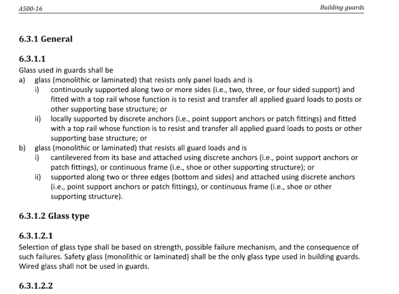

Found it. It appears that is when the glass is only designed as interior fit panel. It would appear that b)i) would allow you to proceed without a top rail. But in my experience, the glass needs to be quite thick in that case. I believe the new Oilers Arena in Edmonton has cantilevered glass guards everywhere and it is 1" thick (approximately I don't have access to the documents directly).
CSA-A500-16 Building Guards

As far as I know A500-16 has not been adopted by the building code as a reference standard. We have had issues with building officials in the past where they did not require a top rail and others where they required one full stop.
Sure hope your project isn't in Ottawa.
I've dealt with them on numerous projects and fail anything that doesn't have a top rail.
