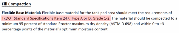

My soil report states the following regarding the site preparation (see information in the link):

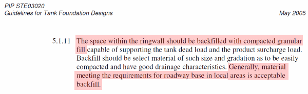

Load capacity of the existing soil within the ringwall is not needed. Per the PIP document (page 12 of 81), that soil is removed and replaced:
Replacement material is specified in your soil report:
Here is the link to the specification for TxDOT Standard Specifications Item 247, Type A or D, Grade 1-2.
The TXDOT Type A material says "Type A: Crushed stone produced and graded from oversize quarried aggregate that originates from a single,naturally occurring source. Do not use gravel or multiple sources."
But from PIP, it appears that the Crushed Stone Ringwall is a different type of foundation than the Concrete Ringwall Beam. So, would crushed stone still be applicable for a Concrete Ringwall Beam fill for the space within the ringwall?

I may need to do the portion of the quote in BOLD.
A Crushed Stone Ringwall is different than a Concrete Ringwall... but that is like comparing apples and oranges.
You have told us your design is for Concrete Ringwall.
If you are going to use the PIP guidelines, follow the Concrete Ringwall section (Paragraph 5.1 and sub paragraphs - pages 11 & 12).
Note that the section I quoted above is Paragraph 5.1.11, which applies to Concrete Ringwalls.
The requirements for Crushed Stone Ringwalls (Paragaph 5.2 and sub paragraphs - page 12) have nothing to do with a Concrete Ringwall.
